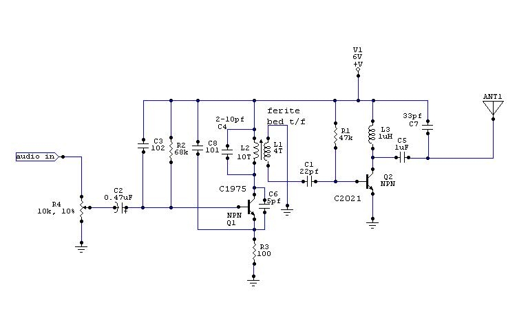

I am new here. I was wondering what the easiest way would be to generate a frequency at 100.3 megahertz to disrupt a radio signal over an effective distance of no more than a 100 foot radius area. (Its not a big deal if it goes over that.)

You could build this highly illegal project and set it to 100.3Mhz and allow the FM capture effect to silence the offending radio. If you adjust the power level so it just mutes the annoying radio, you MAY not interfere with someone else's reception as long as they are not within the same radius. Give or take a few hundred feet.

I appreciate the quick response. That looks like it would do the trick, though I don't want to go overkill on it. I was thinking possibly a frequency specific circuit with minimal components, possibly with a variable capacitor for fine tuning the frequency. I like to be able to build things from scratch if a project allows it.
You could build this one, but it will drift a little bit so you may have to occasionally retune it and it is not as powerful. You could eliminate the mic, along with Q1 and it's associated circuitry, for your application.
you can try the attached circuit too
edit: L3 is 10T, 26SWG coil. air core

Or if you read through the thread with audioguru's FM transmiter, you can find the circuit for the monomiter that he talks about. I have seen them in action before (but never made one) and they are really high quality. They had it hooked to a variable power supply, and I'm not sure what they did to the circuit, but it didn't stop transmiting until it got down to about 2.5V
