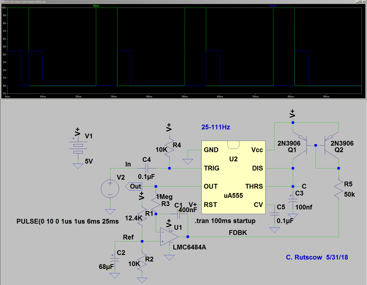

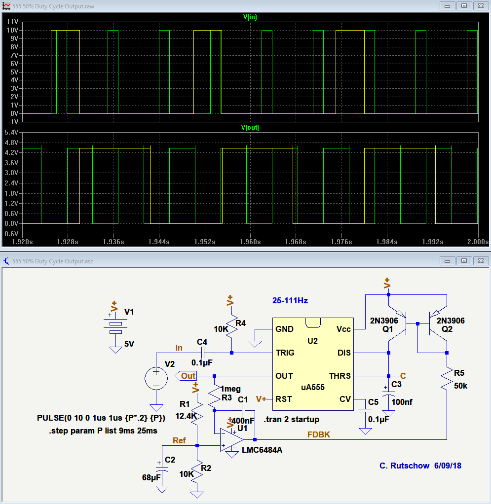

Here's a 555 circuit that uses feedback to generate a 50% duty-cycle output signal, independent of the input duty-cycle, within it's operating frequency limits.
U1 integrates the 555 output and adjusts current-mirror Q1-Q2, which controls the 555 one-shot time, to give an average output voltage of 50% of the peak voltage. This occurs only at a 50% duty-cycle.

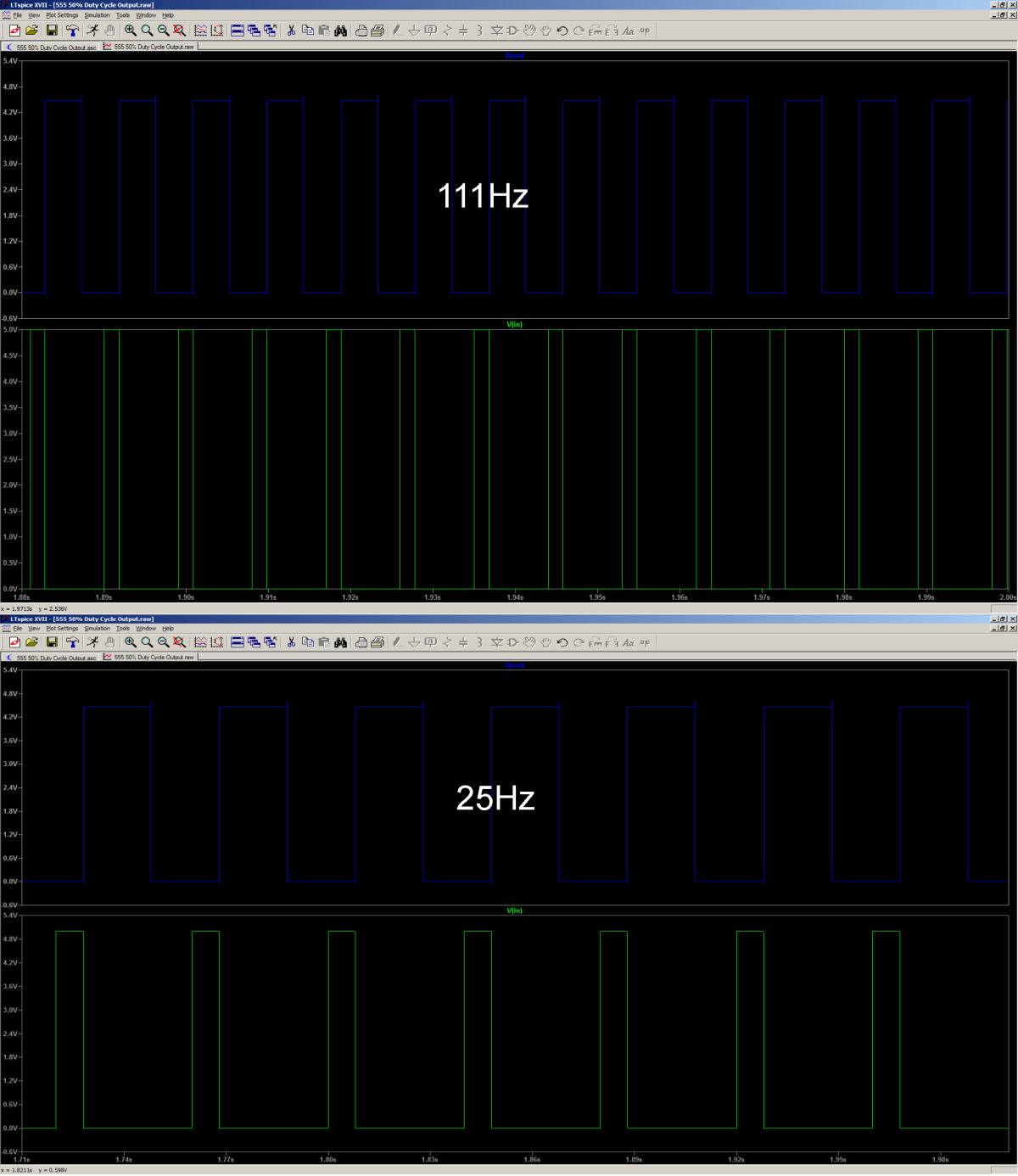

The LTspice simulation is shown for input frequencies of 25Hz (yellow traces) and 111Hz (blue traces) with 20% duty-cycle.
The output duty-cycle is 50% for both frequencies, as desired.
The values shown are designed for a frequency variation of about 25 to 111Hz.
You may have to tweak the values of C3 and R5 for the VSS frequency variation you expect.
(What are the frequency lower and upper limits?)
The circuit operating limits are when the integrator output hits either the positive rail at a low frequency or ground at a high frequency.
You would then frequency double this signal for your cruise-control.

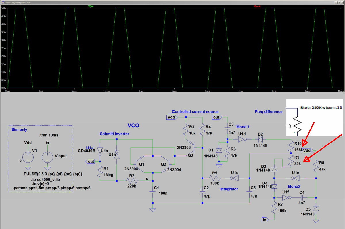

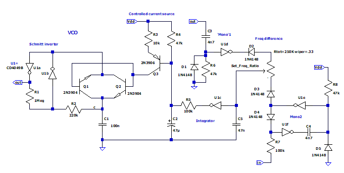

Here's an alternative design, which (in simulation at least!) accepts various input duty cycles and pulse shapes, gives a 50% output duty cycle and enables adjustment of the ratio of the output and input frequencies (including non-integer ratios). I set myself the challenge of using a single IC, so the design is somewhat unusual :).
U1 is a hex inverter.
U1a,U1b,R1,R2 are configured as a Schmitt trigger inverter. Q1,Q2 ,Q3 provide a controlled current for charging/discharging C1, and together with the Schmitt inverter form a VCO whose frequency is controlled by the voltage on C2.
The VCO output drives a 'pseudo-monostable' Mono1 (C3,R6,U1d) to give fixed-width brief pulses which, via D2, act to pull down the top end of the pot and hence discharge C5.
The input pulses from the VSS trigger a true monostable circuit Mono2 (U1e,U1f,C4,R7,R8,D4) which outputs brief pulses having the same fixed width as those from Mono1 and which, via D3, act to pull up the bottom end of the pot and hence charge C5.
The pot sets the relative weighting of the pull up and pull down effects and hence the integrated mean voltage on C5. When this voltage crosses the threshold of U1c the gate output flips. U1c output is smoothed by R5,C2 to give the VCO control voltage. By virtue of this feedback, the voltage on C5 stabilises at close to the switching threshold of U1c, i.e. at about Vdd/2, and VCO frequency /VSS Input frequency is set by the pot.

The width of the fixed-width pulses might need to be tweaked according to the number of teeth on the reluctor wheel of the VSS.
Edit2:
The time constants R(pot)C5 and R5C2 will need tweaking depending on the input and output frequencies.
The frequency range is Spot On Perfect.

Hi Alec,
I could not find a potentiometer model that worked (ie did not get an error flag) I tried improvise but nothing....
Can you share your potentiometer model

There's a mistake in my sim. V2 pulse should be 5V, not 10V.
You need to run the simulation at least 1.5s to allow the various long loop time-constants to settle.
100ms is not long enough.
Look at the Ref and FDBK voltages.
Please don't arbitrarily change my simulation parameters and then wonder why it doesn't work right. :rolleyes:

The sim needs to run for at least 1 sec to stabilise. (You can monitor the stabilisation by plotting the C2 voltage).
This circuit could run at a higher voltage (provided the output voltage doesn't exceed what the ECU is expecting), but in an automotive environment you would need a regulated supply voltage (e.g. 9V) and additional components for spike/surge/reverse-polarity protection.

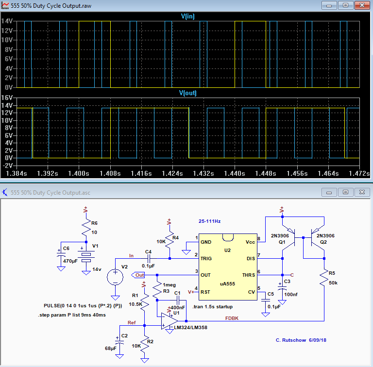

I have tried Mr Crutschow's Circuit at 14V, it works but does not produce a 50%DC.
To adequately demonstrate my ignorance I assumed that R5 (50k) controls the feed back current.
By varying R5 I can get back to DC50% but not at both 25Hz and 111Hz for the same R5 value.

Here's the simulation with an LM324 at 14V, and it works for both 25Hz and 111Hz.
To get a 50% duty-cycle I did need to change the value of R1 to compensate for the output voltage change.
(V(Ref) is set at 50% of the output pulse amplitude, which is slightly less than the supply voltage).
I originally used a Rail-Rail opamp since it would give a higher dynamic range. but the LM324 is adequate for the simulated frequency range.
