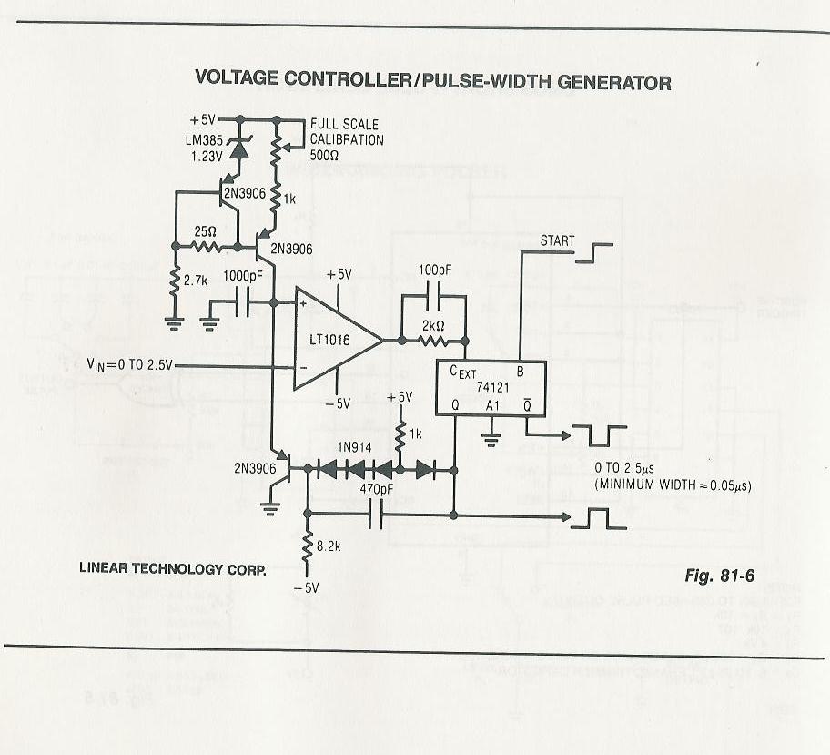

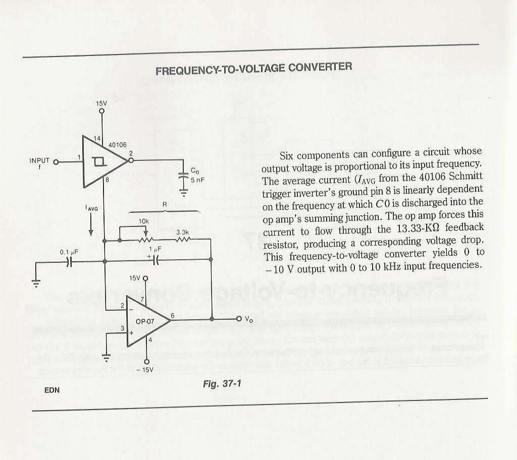

there are number of circuits you can find on net for changing duty cycle by applying/ varying a voltage using a pot, or etc. its basically a PWM. what else you have to do with is to have a frequency to voltage convertor and then feed it to the PWM circuit.
see the attached pic of Freq. to voltage converter and voltage controlled pulse width generator, you may need a squire wave input to complete it. some one has posted a circuirt for PWM with variable frequency in a different post. it also can be usefull with slight modification. you have to combine all in good way to get your accuracy.

Your help said that i need two block:
block 1 ) Freq. to voltage converter
and
block 2 ) voltage controlled pulse width generator
but in the two circuit to change the voltage (block 1) and to change the duty cycle (block 2) there are variable resistors.
i have a rectangular wave with variable frequency,
changing the frequency of the input signal should vary the duty cycle of rectangular wave output.
If you feed block 1 into block 2, that will do what you want. The variable resistors are to customize the circuit for the actual frequencies you need.
