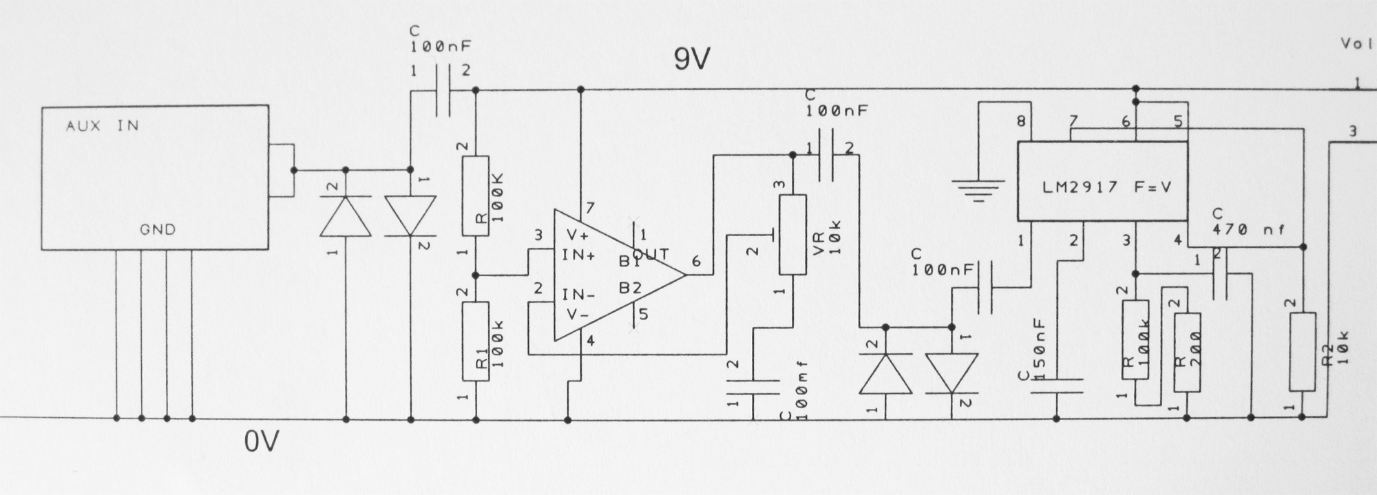

hey guys,
I am currently working on a final project for my university studies and I am running into a bit of trouble. I am using a 741 Op-Amp to amplify the signal from an electric guitar, which in return is fed into a LM2917 Frequency to Voltage converter (necessary for PIC 16F microprocessor). Now here is the problem, according to the LM2917 datasheet, the accuracy of the voltage output depends on the values of capacitor 1 and resistor 1. I have spent hours trying to figure it out but either I get a very inaccurate output with the voltage constantly changing or I get a precise output but which is capped at 8V with the components used on the schematic. I would greatly appreciate the help as I am getting close to complete frustration :S
The circuit is powered with 9V
The description for finding R1 and C1 is found on page 7. I understand the calculations and the process but I think I might do something else wrong that I am not aware of.
LM2917 Datasheet:https://www.electro-tech-online.com/custompdfs/2011/03/LM2907.pdf
Thank you very much for any advice in advance
Phil
One of our first projects involved the 741 and therefore thought I might as well stick with it. The PIC 16F628 should determine what note on a guitar is played by converting the frequency produced by each note. The aim of the project itself is to build an instructional guitar displaying the player the notes from a song using shift registers and checking whether the correct one has been played.

What is wrong with the diagram?
At a brief glance here's no connection to the input of the opamp, and there's no power supply decoupling, it's really a pretty poor effort.

The answer you are looking for is that you are using the wrong IC... the LM2917 has a protection Zener diode that limits its operation according to the datasheet to 7.56V(page 3) .
If you do not want this protection you should opt for the LM2907 which does not have this added "protection" and will not limit you to 8V out.
