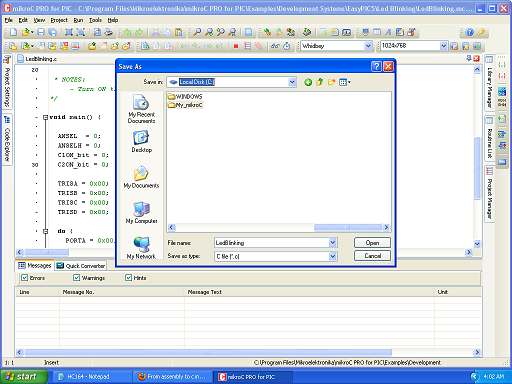

Is it possible to make a .hex file from program "microC PRO for PIC " . I install that program but I think it can't make a .hex file. I use PIC 16f***
MiKroC is some what a pain but here is a some window shot showing how there 10 pic the pictures should tell it all.

mikroc is good easy to learn but if you don't save your project the right way it hard for a noob to find them
