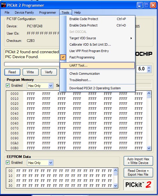

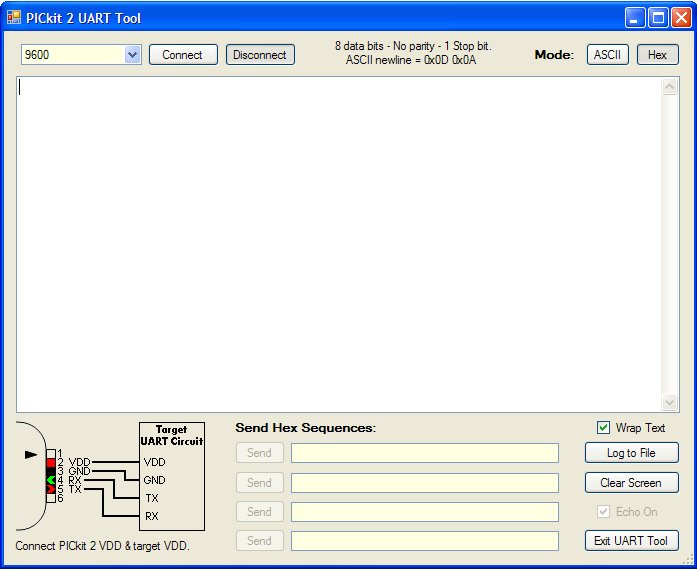

PICkit2 software. TOOLS>UART Tool
UART Tool displays the connection diagram.
Not much more to know.

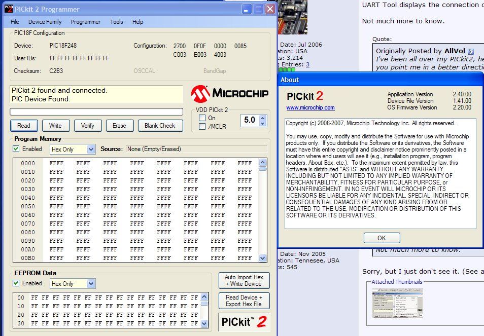

Sorry, but I just don't see it. (See attachment). Being new, I guess I'm just all fouled up.

What version of PICkit2 software are you using? Check this v2.52.
Well, thanks, bananasiong. That may explain it. I just bought this outfit in June, but it is version 2.11. I went to the site you mentioned, and opened it, but it failed to download. I'll try again.
