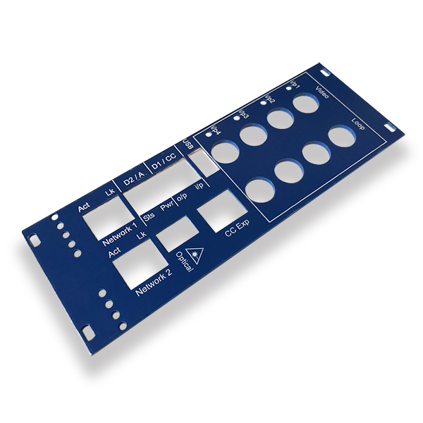

There have been several threads about low cost pcb fab shops. This question is about sheet metal shops. I have a variety of small and medium sized enclosures, and want to know if there is a pcb-equivalent for sheet metal. I'm after a semi-pro look for hobby projects. Very small lots, don't care about delivery delays, prefer low cost. There are places in town that can do this, but the costs are way high.
One option I have considered is having a pcb shop make the panels out of FR-4, but I'd like to stick with aluminum.

Try searching for "Metal label control panel" and see what comes up??
eg.
Heavy aluminium label material is 1 - 1.5mm, about the same as a small enclosure panel. Or you can stick it over a thicker panel.
Aluprint / Anoprint is another technique that some panel/label places can do, it gives phenomenal results, and can be done on heavier aluminium, with multiple colours and the pigment set below the material surface so it does not wear off - but that tends to be expensive.
Another option is Traffolyte or similar (multilayer laminated engraving material). Again, that's thick enough for small panels on its own, or can be used over larger panels.

Honestly, if you want 1-off panels or even a few, the method I mentioned in post #2 is probably your best bet.
A 1' × 2' panel is $50, so it's not exactly cheap, but the cost to laser cut & engrave a panel should be fairly cheap at a service bureau – maybe $5 or $10. Painting the etched labels is literally as I said – slop the paint on to cover the grooves.
I used to use dry transfer lettering. Paint flat light gray, apply the lettering, then spray over with flat matt acrylic spay. Looks good and lasts forever. I used this method to make test fixtures in an electronic test department back is the 70s/80s.
FR4 is an easy solution and you can leave the copper on the back side for EMI shielding.
If that doesn't work, I've used these guys and 4x6 simple, one color was about $75 (there minimum?). The software lets you see the price as you go. They can do inkjet printing with very durable ink directly on aluminum sheet.
Prices of some of their past projects are on their "inspirations" page.
