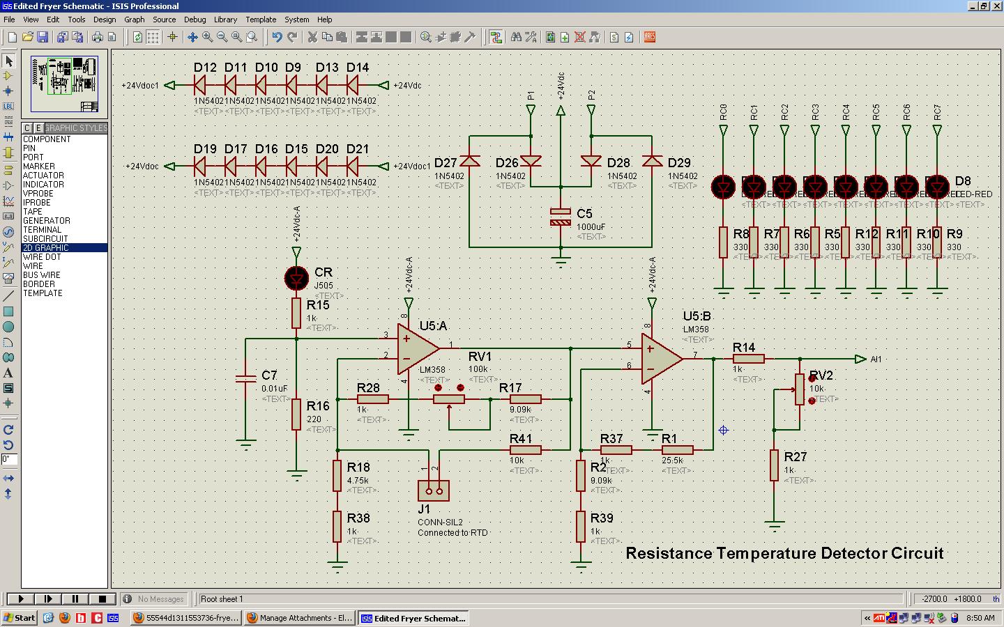

As a starter I planned a lot and my first step is to break down all the project by sections. First will be to check the temperature displayed if it is accurate. What I did is reduce the software codes and remove the routines not related to the temperature. I only enabled the 7seg display routines and temp related routines. I managed to let it work. I am using a Tecal Calibrator which has a built in temperature display (newly calibrated) to test with my RTD.
I decided first to take tests on a stable temperature. I set only 280 deg F on the calibrator and I am not changing it at any times.
Here are my observations: (No fryer used yet but only Tecal Calibrator with temperature display)

The first problem is that the controller takes time to reach the temperature displayed on the Calibrator (for both situations) from the off mode of the controller to the on mode. It takes around 5-15 minutes before it reaches the nearest temperature it can show when the calibrator's temperature is stable at 280 deg F. Another problem is that the temp has around -1 to 10 deg Fahrenheit error on the 1st situation while on the second is a stable 2-5 deg Fahrenheit error.
What I think is that some components used were not in industrial grade meaning most of the components plugged were cheap and can't withstand the temperature inside the controller box. I think changing them to the highest quality will improve the results of the temperature. Another thing is that I think there are internal noises available and I have seen capacitors missed like caps beside the Vcc and Gnd of the PIC and also on the LM358 IC.

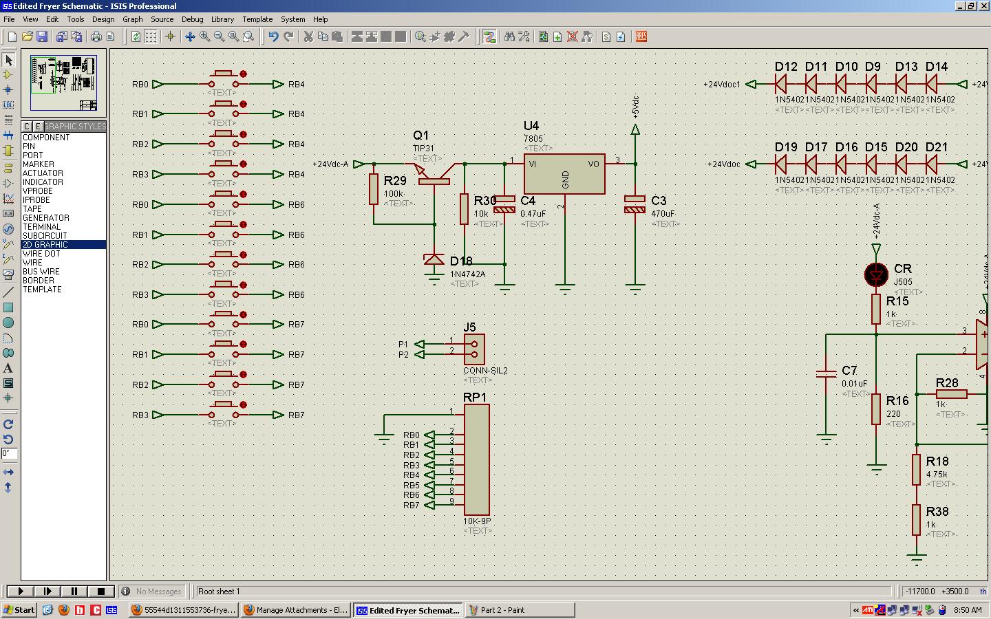

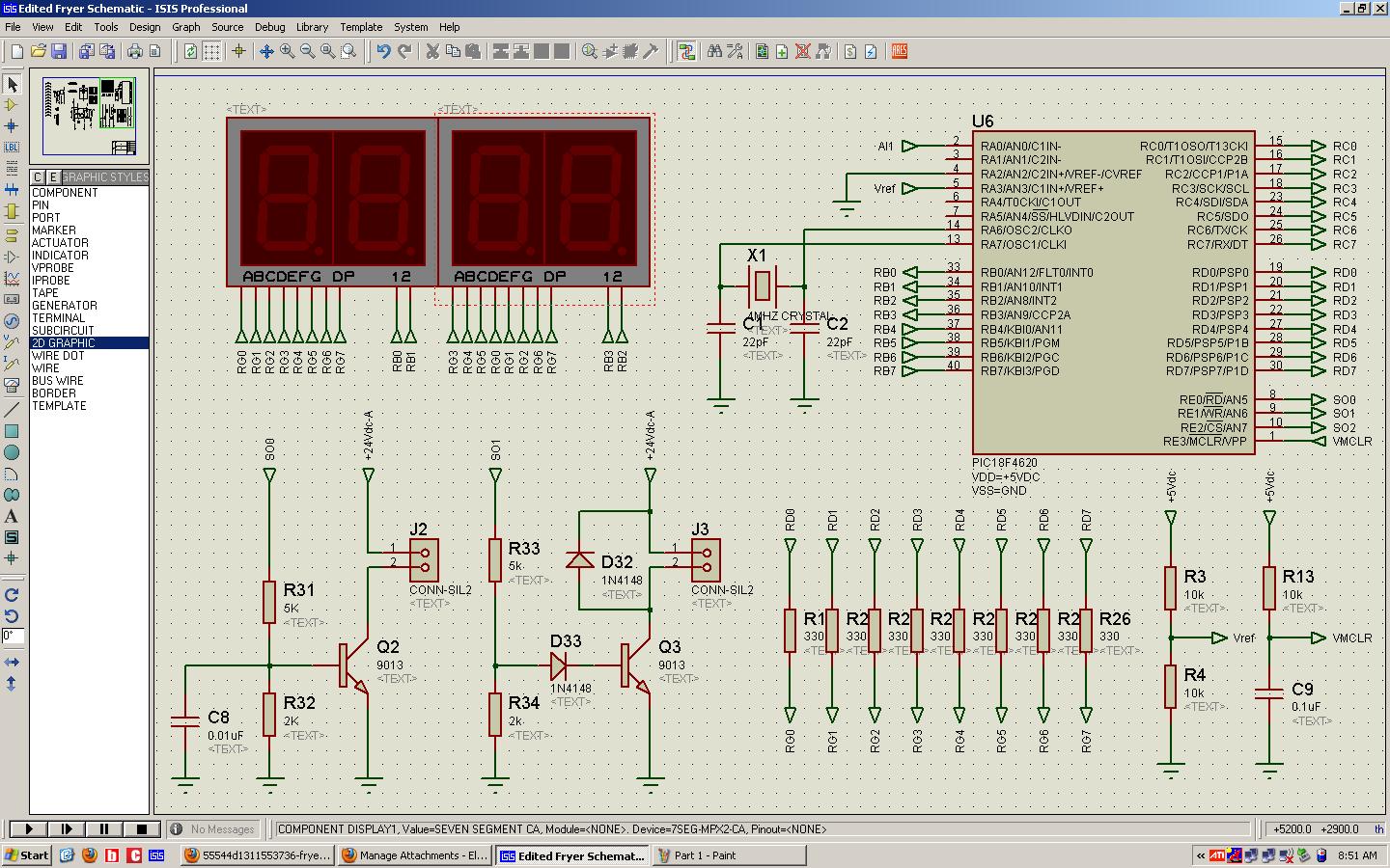

A couple of things, really fast:
1. C3 is WAY too big for it's location.
2. Lack of bypass caps on OP amps etc.
3. You mentioned RTD. Could it be a thermister? They usually have a 100 ohm resistance at 25C They are usually 3 or 4 wire, not 2.
I really don't know why he used a great amount of capacitance there. I usually place 100uF elec cap there but I don't know if it would be right.
Yes, I will be placing like .100 uF ceramic caps on the OP amp and the PIC

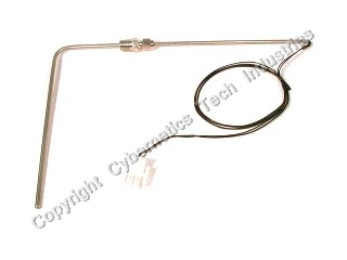

I don't really know what it is. I tried googling the label on it but can't find one. The sensor is already old (like for 2 years already) and we got lots of them here. The people here can't find a datasheet for it and can't remember if there's a datasheet included. At room temperature with no air conditioner it has a resistance of 75k ohms. The sensor looks like this one on my attachment. It's from this website at the bottom part.

The 470 should be on the input side of the regulator. Even 100 uf is too large on the output side. Take a look at the datasheet. Probably a 1 uf electrolytic and a 0.1 ceramic.
The 0.1 ceramic sounds good for the PIC. The OP amp, probably a 1 uf polyester.
That would be a thermister.
Tell me about your 24 VDC supply? Commercial?
Find out if one side of the thermister is connected to the sheath.
Put like a 0.1 metalized poleyester between pis 6 & 7 of the LM358
Take a scope and look around at the outputs (AC coupled) of the OP amp and the power supplies
Looks like a resistance thermometer (RTD) hooked up in a Wheatstone bridge.
See Here; https://en.wikipedia.org/wiki/Resistance_thermometer
I really have no idea about it. But I've read this wiki last time well I think it is. I just can't see an exact product details about my sensor on the net.

Yes, having a look on the datasheet it says .1uF ceramic cap and il just place 1uf elec cap on the 7805's output side. May I ask why polyester than ceramic?

I'm really not sure if it's a thermister or what. :(
What do you mean sheath? Are you referring to the L shaped metal rod? I tried testing both terminals with the rod but none of them is connected to the rod.

The choice of bypass caps is a long one because each cap has it's own purpose and characteristics. Ceramic is generally good for high speed switching. The OP amp should have neither. Ceramic for the regulator would be OK and they are cheaper. There are times you'll actually see a tantalum+ceramic+polyester being used together as a bypass cap.
The suggested polyester in the FB loop would lower the Bandwidth of the OP big time, and make it less prone to oscillate.
The use of lots of diodes is to reduce the input voltage to the 5V regulator by n*0.6 volts. It might not be a smart move. You could see if any improvement would happen if you operated it off a regulated 24 VDC supply and a regulated 5V supply at least for testing purposes. Placing a transorb and a reversed biased diode for spike suppression may not be a bad idea after the rectification. Power line spikes and RF might be getting in and disrupting things, thus good operation would be dependent on the environment. You also might need a power line filter. These are just ideas at this point.

Look at A11 with a DVM and compare to the PIC's value. You need a stable temperature read and you don't have that. Not even with a bath apparently. All the stuff mentioned could impact that. AC line fluctuations and nearby equipment could affect that. No, I don't like the power supply, but that usually is a significant cost.

A small point but for the circuit to work properly Q1 must be a PNP, not an NPN as shown.

I'm suggesting a commercial 5V power supply and a commercial 24 V PS just to prove a point. Tap into the circuit at the proper spots and probably your problems will go away.
Your then left with a few bypass caps and one suggested BW limiting cap. Most of the complaints were power supply related. I'd start there.

That transistor didn't look right, but I concentrated on the other stuff.
