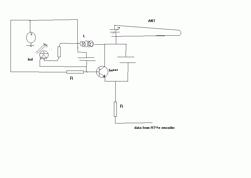

But i have remote car switch , iam trying to understand the way it operates, It uses HT12E as digital data Encoder & one transistor as transmitter
is that FSK technique , if so how the transmitted data rescieved & decoded.

Its hard to say from your description. My first guess is that your remote uses PPM (pulse position modulation) which is a simple form of AM where the encoding chip output is turning the transistor oscillator on and off according to a serial string of bits. This is quite common in North America for garage door opening remotes, for example. If the device uses FM, then the single transistor would still be an oscillator but its frequency may be easily shifted using a varactor diode on its tank circuit fed from a digital serial string of bits from the encoder. Hard to know unless you can spot a varactor diode near the transistor.

Hi all
here is arough schematic for that small transmitter

That's about the roughest schematic I've ever seen here on the boards, but damned if it isn't good enough. I would say that based on this, you have a pulse transmitter which is where the RF carrier is turned on and off according to a sequence from the encoder chip. The fact that the encoder controls the DC flow throught the transistor emitter is the best clue showing the encoder is turning the oscillator on and off.
