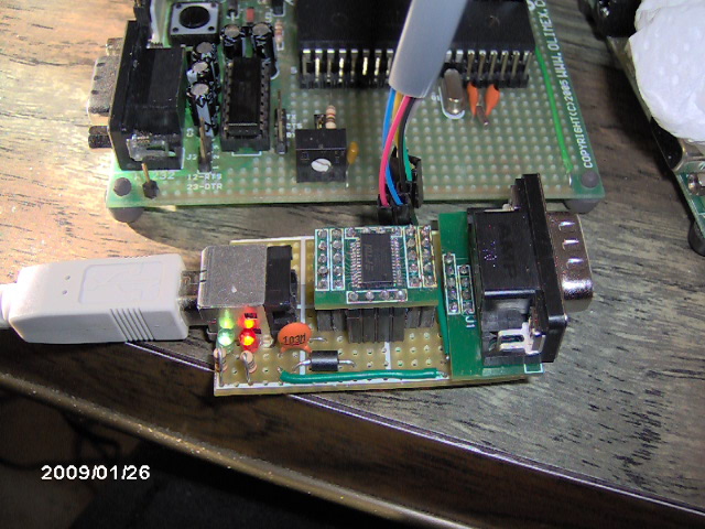

Got around to pasting a FT232R onto a proto board to give it a go. Windows XP recognized, it and was able to then install the latest driver.
Not having any luck communicating with a terminal, getting some gibberish, so TX from the PIC-->Max232 seems to be working. The odd thing is that a loopback test works just fine by shorting the RX and TX pins on the PIC side of the Max232.
In the Bray's terminal the transmit window indicates a 'frame error'. Played around with different baud rates. Tried device manager to change the ComPort buffer to smaller values, 64 bytes and latency to 4ms. Tried inverting the RX and TX in the Mprog (FTDI eeprom programmer), that didn't work.
Using a Prolific USB/Serial cable everything works as expected, so the software shouldn't be a problem.
Will say that the manual shows a 0.01uf polarized cap across the power pins on the bus powered setup that is implemented. Only able to come up with a ceramic cap for that, could that be a problem?
So checking to see if anyone has had this 'frame error', and where I might look to fix it.

I'm missing this somewhere. I don't see in the datasheet where it says the inputs can handle RS232 levels. The max voltage for inputs is 0.5v over and under VCC. There is an example of driving the TTL side of a MAX232, but nothing about receiving +9/-9v from a MAX232.

Thanks one and all for your responses. The overwhelming consensus was to use it with the TTL interface. Wired it up and it worked, of course!
The idea of running it thru the Max232 was to mimic a USB/Serial cable. In the data sheet it does show hooking up to a RS232 converter, although I don't have their specifically recomended one. Will give another go when I have more time.
The Pic was a 16f877a on an Olimex Pic-40 board, so no problems there. A software serial routine was being used based on Nigel's assembly routine ported to GCBasic.

I'm still not understanding what you were trying. The datasheet example show DSUB Connector -> MAX232 -> FT232R -> USB setup. The RS232 level signals are going out the DSUB. In this setup, it's exactly the same as your Prolific USB/Serial converter cable. What's the point of that, you already have a USB/Serial cable?
What it looks like you were trying to do is uC -> MAX232 -> FT232R -> USB in that case the RS232 level signals are going into the FT232R. That's not going to work no matter how you try to do it.
Level shifter, got it, really appreciate the extra eyeballs and thoughts. My brain was inserting 'transceiver' for some reason, ..uggh:eek:. Okay gonna get out the hacksaw and chop off the DB9 connector, hehe.
The excercise is really to learn a little about the FT232R chip and hopefully apply to a homegrown prototype board for some 40pin pics. I like the idea of using the USB port for power, and of course the serial communications.
