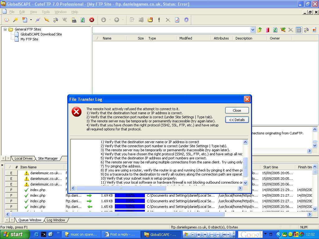

i use cute ftp 7 it is very good complete controll over everything, and yes you can see the command window. i have a screen shot.
i have used the username, ip and password before. it saves them.

Hi, what I was hoping to see was the debug window,( right behind the File Transfer Log Window in your screenshot. :D )
If you can get a log of the connections debug output, you should have a good chance of determining why the connection fails.
Try running CuteFTP in debug mode, with all connection settings to "automatic", this may help get the settings right.

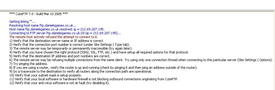

here is the debug window. i have three computers, let say the one with the modem i 1, my computer is 2, and my sisters is 3.
here is a crude layout of the network.
________ ___ __ __
¦internet¦--------¦1¦-----------¦2¦----------¦3¦
dashes are network cables.

yea susan is my mother. i can ftp into that acount i tryed it at school, i also tryed ftp from my sisters computer(which doesnt have a firewall or a antivirus) and i disabled here windows firewall to try it.
Your computers being wired the way you've shown, computer #1 should have 2 ethernet interfaces (network cards), one connected to the internet using the actual IP address provided by your ISP, the other connected to your LAN using local, non-internet-routable IP addresses.
Computer 1 acts as a proxy, making requests on the Internet on other computers' behalf and routing the responses back. If all 3 computers currently can access websites (HTTP) but not FTP sites, you only need to tell your routing/proxy software configuration to do so. Not knowing what kind of software routing you're doing, it's hard to give advices. Look for ways to allow traffic on port 23, which is the standard TCP/IP port for the FTP protocol.
