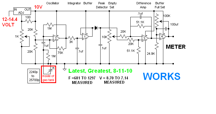

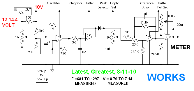

Got this capacitive fuel gauge sender design from Kit Plane and after modifications, Here's what I have. Would any one like to suggest any improvements or changes?
The change of voltage / level change is greater as the tank gets empty.
Jim Weir's Kitplanes Addendum see June, July, Aug 2000
Thank You,
Kinarfi

It looks like the 324 at 8.7 volts may be against it's high side rail.
Sorry, forgot to mention that the op-amp is a TI TLC27M9CN, The oscillator and peak detector are working fine, but my difference amp isn't, it switches from the 0v rail the 10v rail when I lower the empty set and stays there until I remove the power and reapply.
Guess I have some more learning about difference amps to do.
kinarfi
You know I could be wrong but I think the + & - on the buffer amp is backwards... It's all positive feedback. Also the 8.7 volts will be above the common mode voltage (see note 5).

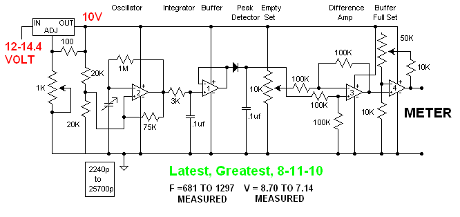

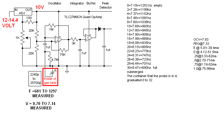

The first drawing didn't work, Maybe this one will, the difference amp & buffer - full set have been changed and tested on LT Spice. I will build and test and write down my measurements.
My variable capacitor is 2 aluminum sheets, 16" x 7" rolled up together with 1/4" bird netting between the sheets so it doesn't short out or get capillary action between the sheets. About 1 1/2" diameter.
Kinarfi

Took it to the work bench and changed a few parts and tried it with real gasoline, with proper safety precautions, and the empty set worked and the full set worked, very happy with it.
kinarfi

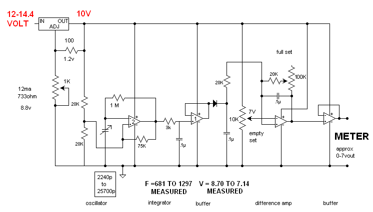

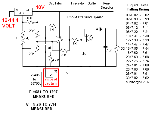

Here's what I have now.

I need a tad bit more help please, It turns out my fuel gauge works backwards or with current instead of voltage, the readings that I took are:
OCV=7.83V Needle pegged at empty.
Max current = 109ma measured with the 10 amp scale, 106.1 on the 400ma scale, needle pegged full.
Full = 98 ma @ 0.75v
3/4 = 82 ma @ 1.91v
1/2 = 71 ma @ 2.70v
1/4 = 62 ma @ 3.33v
0/4 = 52 ma @ 4.12v
empty = 39 ma @ 5.00 v (0/4 is top of the red zone, empty is bottom of red zone)
I'm looking for ways to convert what I get now (voltage 0 to 5 or 7) to what I need for the meter I have (current?) Looking at the voltage to current op-amp configuration. If you know what I need, a push in the right direction would sure be appreciated.
Kinarfi
I dont understand your meter. Are there three connections to it or only two? Is the case grounded? (That might be the third connection?)
The circuit should work as is with a simple voltmeter (high impedance milliAmp meter). Try connecting your DVM in volts mode where your circuit shows METER. Is the voltage there proportional to the fuel level?
Sorry for the confusion, what I have been designing is a sender unit to replace the existing unit which has 4 reed switches activated by a magnet on a float, full 3 ohms to ground and empty is 110 ohm to ground.
**broken link removed** **broken link removed**
The measurement in my previous post are what I read while watching the gauge and adjusting a pot and reading one dvm for current and another for voltage. Not the most accurate method, but the readings indicate that the gauge sends out 7.83 v and the max current is 106 ma and I calculated an internal resistance of 72 ohms. The gauge is powered by the 12.4 volts of the vehicle and sends power to the tank sender unit, pictured. I hope I explained it clearly, if not please ask.
Kinarfi

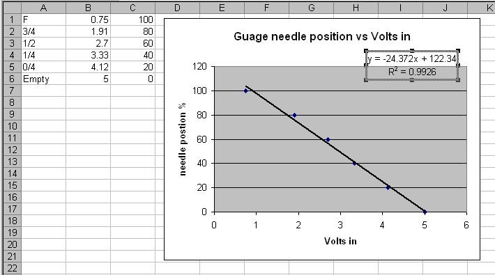

Looks like the gauge is fairly linear if you just drive it with a voltage source. Note I assumed the needle position as a percentage of travel across the face. If what I assumed is not correct, tell me...
In order to invert the gain/offset stages in Jim's circuit, I would need a plot of Voltage at the cathode of the diode vs fuel level in the circuit as it is now.

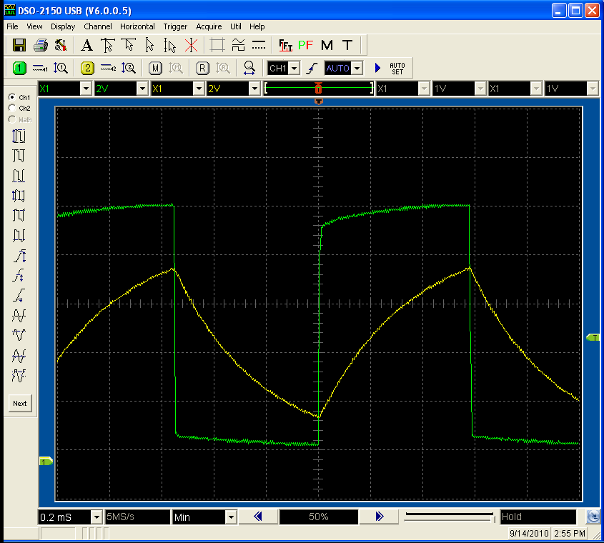

Here they are in the attachments, here's the wave form I'm getting, just FYI.

I wanted you to leave a load on the Diode detector. By removing the down-stream circuit, the unloaded output across the capacitor is unrealistic. Put a 100K in parallel with the right-most 0.1uF, and plot the calibration curve again...

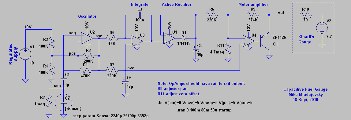

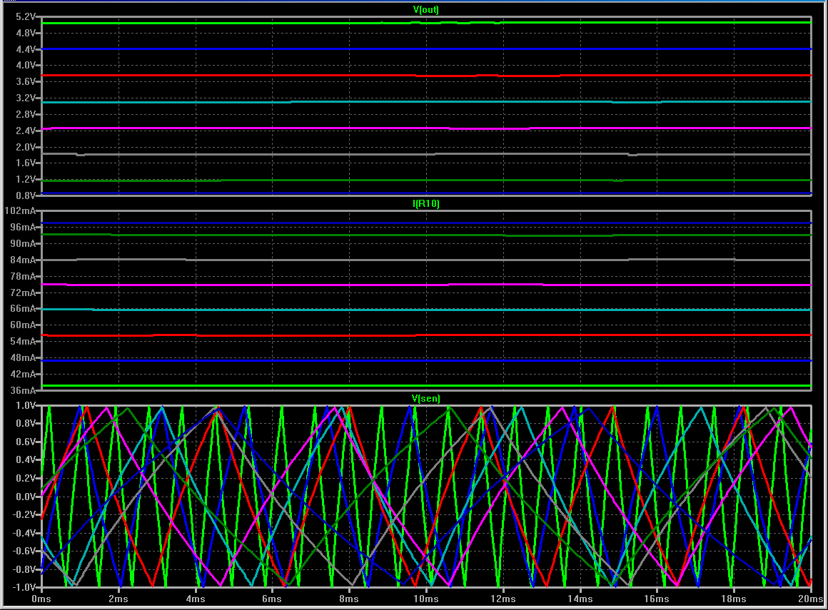

After a lot of work, here is my "improved" version of Jim's circuit.
1. I incorporated Jim's oscillator and other suggestions. The voltage across the sensor is constrained to be +-1V, no DC offset, shunted by a 1meg static drain resistor.
2. I made the integrator a "true opamp integrator" instead of just a simple RC network. I optimized the time constant for the range of frequency based on your measured sensor capacitance range.
3. I used an "opamp active rectifier" as a peak detector, and improved the filtering at its output.
4. I designed an inverting meter driver which is capable of sinking ~100mA to drive your weird gauge.
5. The simulation steps the sensor capacitance in seven steps from 2240pF to 25700pF (3352pF increment).
6. The plots show V(out) the voltage at the gauge input, I(R10) which is the current sourced by the gauge, and V(sen) the voltage across the sensor at eight different values of sensor capacitance. Note that there is a slight amount of compression between the C(sensor)=2240pF and C(sensor)=5592pF, but the other six steps are equally spaced.

Thank you Mike, I have been out for a few days and I'm going out again shortly, so it will take a few days or weeks to sort this out, build and test, but I will certainly let you know how it worked.
