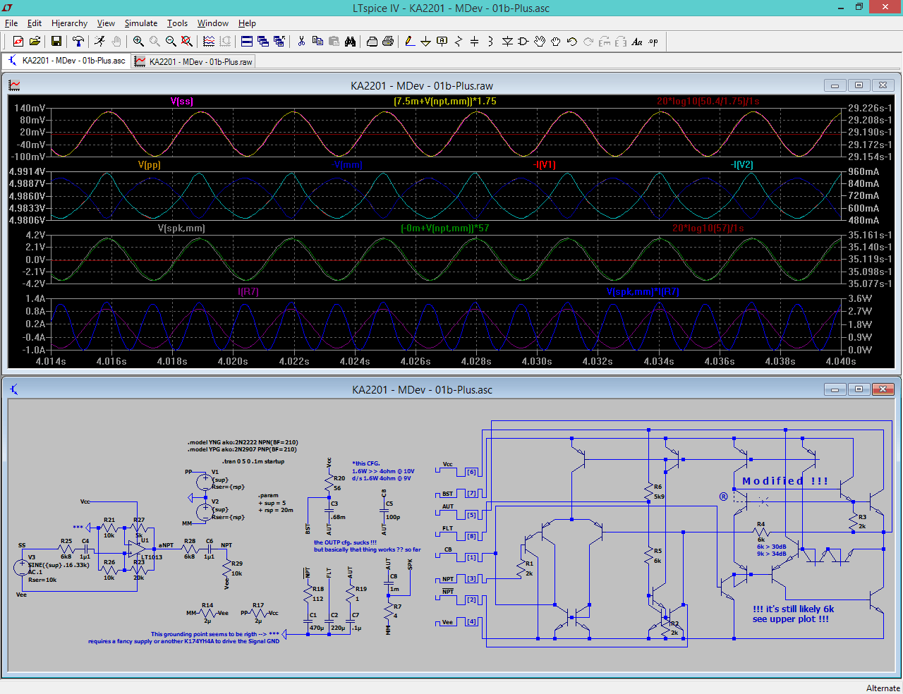

• I always get nervous with the d/s-s coz there are just loads of misc. errors
• this is the second amp i had to redirect a part of the reference ground ??? i donno much of audio but the test circuit definitely isn't what it suppose to - again - on d/s ((or the audio guys are stupid . . . ))

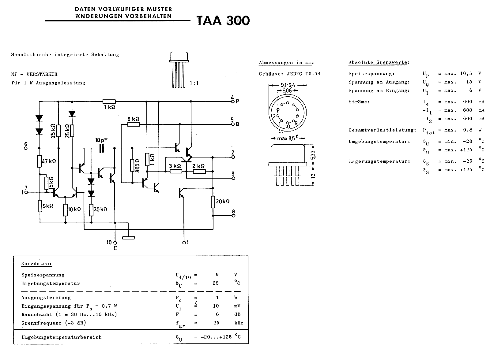

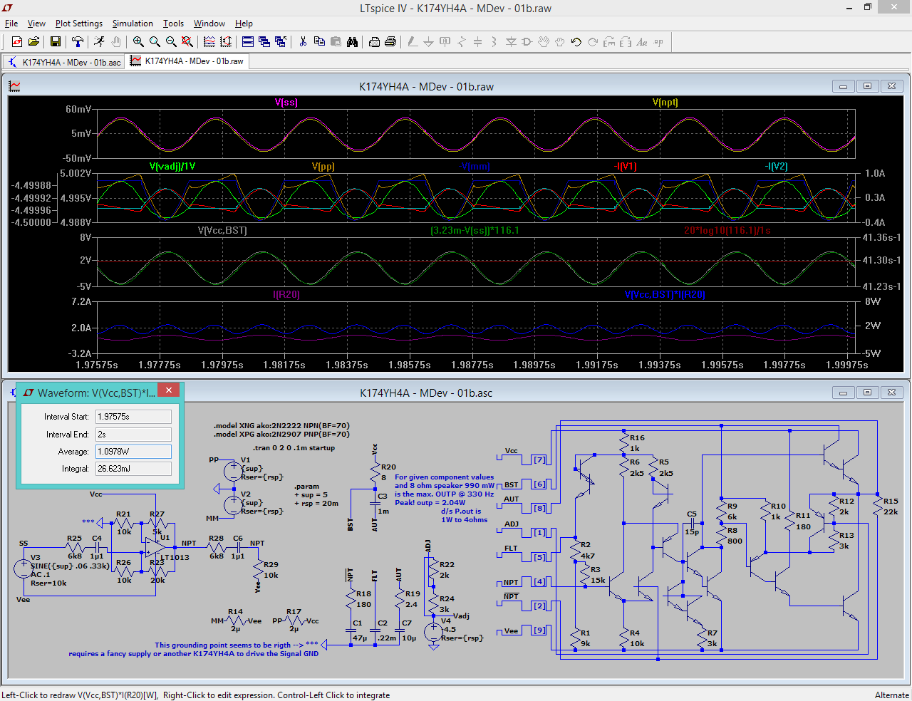

• the russian К174УН4 is apx TAA300 -- again i wonder which lists the correct schm. -- coz i actually got that ru.1 to work ??? ((won't test the other coz i don't have the chip to compare against))
I do not trust datasheets because there are lots of different errors.
I have had to correct ground connection errors in the second amplifier circuit drawing
I do not have a a lot of experiencing of audio circuits, but I gave it a try.
the circuit is not correct compared to the datasheet or else the audio experts are dumb.
• the russian ?174??4 is apx TAA300 --
The Russian 174 is a TAA300 IC
I am not sure which lists the correct schematic circuit.?
because I got the Russian one working OK.
Unable to test the other circuit as I do not have the LTS model for that IC.
