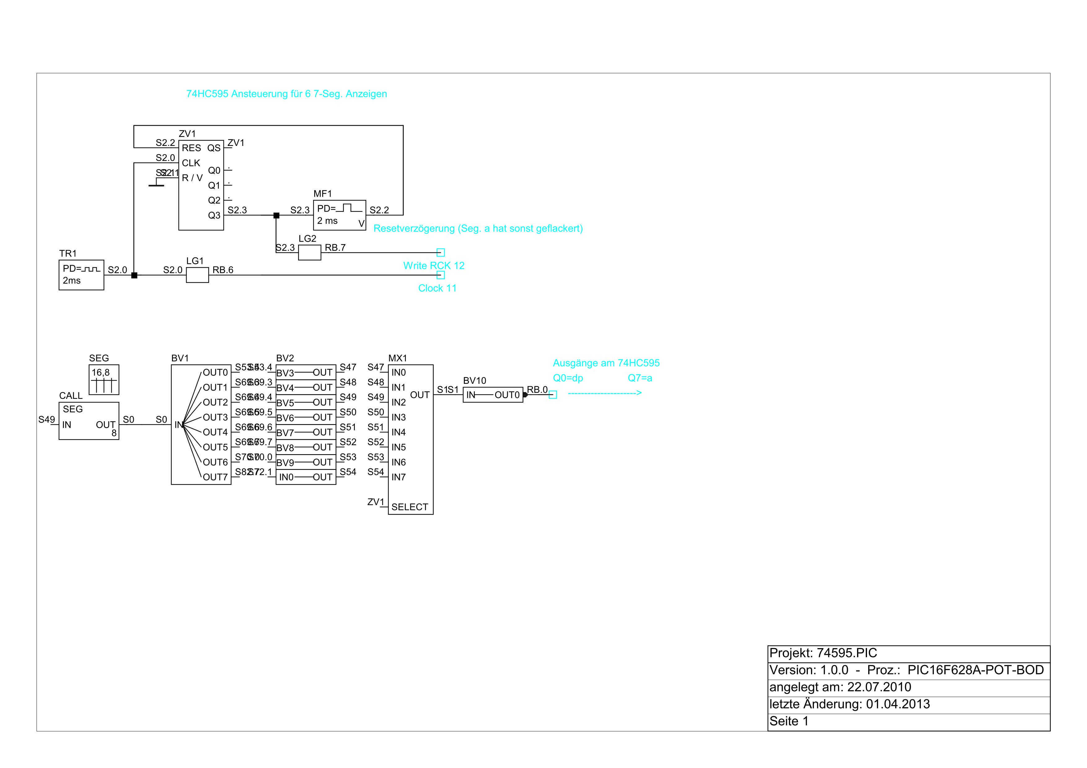

Hi Lourens,
pity that there is so little interest :-(
Since I can not programming language, VPS_P18 is a great solution for me. Until now I am using "Visual Parsic" which was discontinued in 2008 and "only" PIC12/16 support. There I realized with the 74595 multiplexer and bitswitches (picture)

Hi Lourens,
thanks for the answers :) Parsic also a simulator mode but has no online debug mode. I once attached a demo version, maybe they can from it "steal" some information;-)

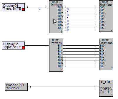

Shift Register/7-Seg driver
Hi Steffen, took some time with your request for a 7-segment driver. The Function Block i made a bit more general purpose - it will accept 8 bit values for shifting out to the 74LS595. I also added a Function Block to look up the 7-segment patterns. For the driver FB you can select the port pins to be used for SER, SCK and RCK it is possible to use the same line for SER and RCK on more than one 595. (tested it on 2 chips as indicated in the screenshot). Will do the documentation and setup file and have it ready in a few days.

Hi Steffen
Attached is the installation file (and a ReadMeFirst file) for VPS_P18 Ver 2.02.
Manage to include the block (FB24) for driving your 74LS595 and another one (FB107) for selecting 7-segment patterns. To us right click, then select 'Add Function Block >Pheripherals>SERIAL_OUT.....FB24, and for FB107 select ...Multiplex>Sel 1 of 11 Patterns'.
I have tested the driver with two 74LS595s and it seems ok. Execution of a FB24 takes 10.5uSec. In the documentation for these two blocks, which i will post in a day, is mentioned how to use one port (8 bits) to drive 6 of the 595s.
