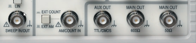

Function generator outputs are connected to earth?
It would be pretty unusual to have a full floating f() generator, or so I think. I dont
see a differential marked pair of BNC out.
Measure ohms between bnc shell and line neutral of its line cord.

Does it have a three core mains lead or a two core one?, as it's in a plastic case it's likely to be a class-II device with a two core mains lead, so no earth. Such devices are often two core, if it's three core them measure from the earth pin to the BNC sockets see if it reads between them, if it's earthed it will be low resistance.
I wouldn't measure from neutral to BNC, as it shouldn't be connected to neutral.

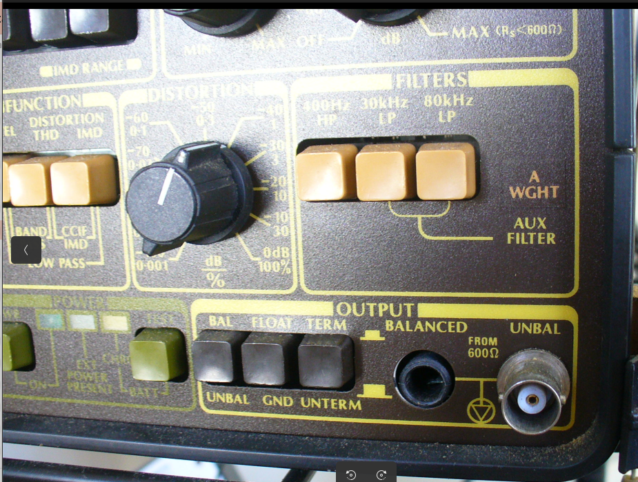

My audio generator has balanced or unbalanced selection...
And a serious instrument should too.
Except it's a chassis symbol, not a ground symbol.
If the chassis is connected to the power cord 'ground' green conductor; is the BNC symbol both ground, common and chassis ?... And mains neutral too at the breaker box ?

You're assuming it has a three core mains lead?, it's more likely a class-2 device, double insulated with no earth lead. As the front symbol is chassis, it's another potential indication that it's only a two core lead?.
But the datasheet in the OP is completely useless, and tells you almost nothing. However, the instruction book isn't much better (no pictures or diagrams), but it does say "WARNING! THIS INSTRUMENT MUST BE EARTHED", and a lot of searching finds a reference to it being class-I.

Do you agree, that this function generator's input and outputs are all referenced to earth ground, and it cannot be disconnected from earth? ground?
TG550 func gen
It seemed obvious to me , so I had to find proof. p.7 https://resources.aimtti.com/manuals/TG550_Instruction_Manual-Iss9.pdf
"Any interruption of the mains earth conductor inside or outside the instrument will make the instrument dangerous. Intentional interruption is prohibited. The protective action must not be negated by the use of an extension cord without a protective conductor"
Yes, you can disconnect at your own peril during a thunderstorm ;) or measure the stray leakage in the transformer with your hand on PE. Possibly, they intended you to want an external PE to avoid a ground loop on the DUT. Hence the CYA legalese.
