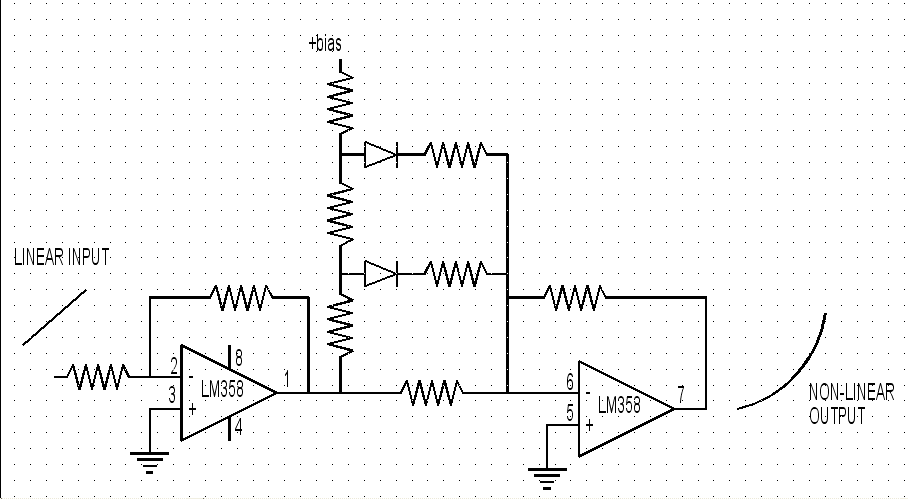

The log sweep produces a log display of frequency but the voltage sweep that drives the modulator is not logrithmic. You need a shaper circuit to convert the linear sweep to logrithmic. The attached plot is an example.

So its a Frequency sweep VS voltage sweep
What kind of shaper circuit ? where can i find these shaper circuits?
They are AC shaper circuits or DC shaper circuits?
You can make a piece-wise linear DC shaper with diodes. The basic idea is shown below. I used to have a program that would calculate the values for an arbitrary curve but it is lost in antiquity. Ratz! I got the diodes backward, turn them around.
