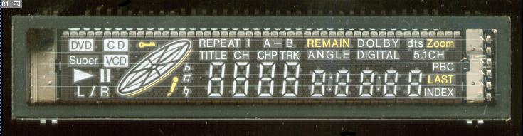

I tested several displays, the one from the CD player has
only 6 grids. REPEAT 1, TITLE, CH and the segments of the
two large digits below are addressed by grid 2, everything
to the left is addressed by grid 1 . . .

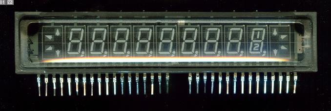

The second 11 digit display has 11 grids, I only tested
a few digits and segments to confirm what I already knew
because the grids are clearly visible and they look like
grids too.

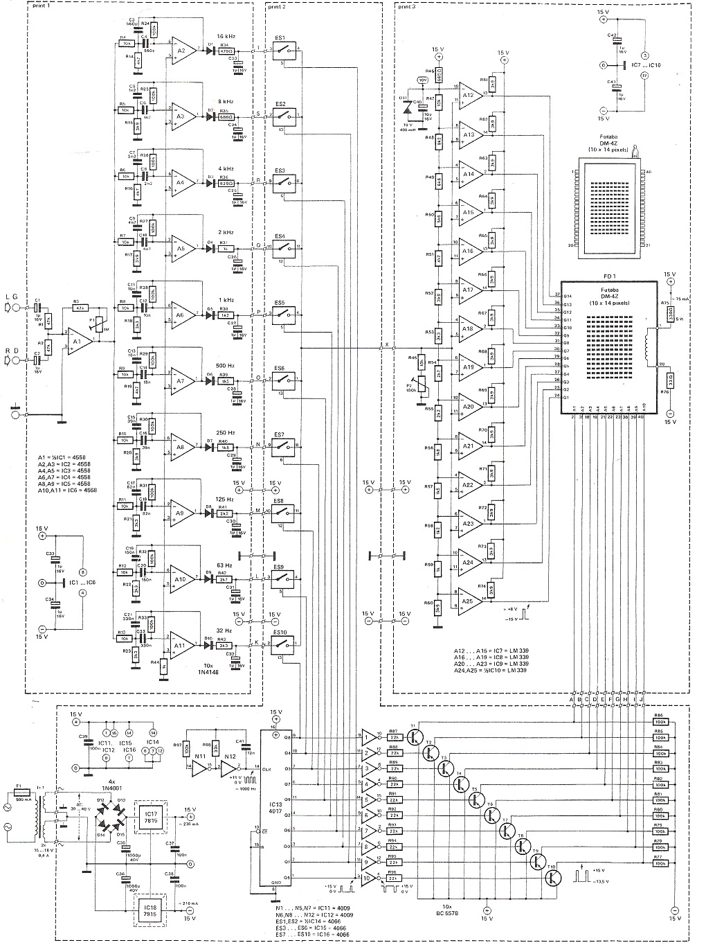

Futaba DM-4 VFD
Ok peoples........
The attached picture should give you all the answers you've asked for.
Again, you do not need hundreds of volts; just -15 and +15VDC.
This is a schematic from an audio spectrum analyzer and it works great.
Hey, in return........ where can I buy one of these?
These displays are AWESOME!!!!!!!!!!!
Anyway.... have fun!!:D
P.S.> ya it's an older thread but ALWAYS appreciated!!!

I am not sure where to buy these but maybe check ebay, or take some VCRs or DVD players apart and see if they have one of them inside.
