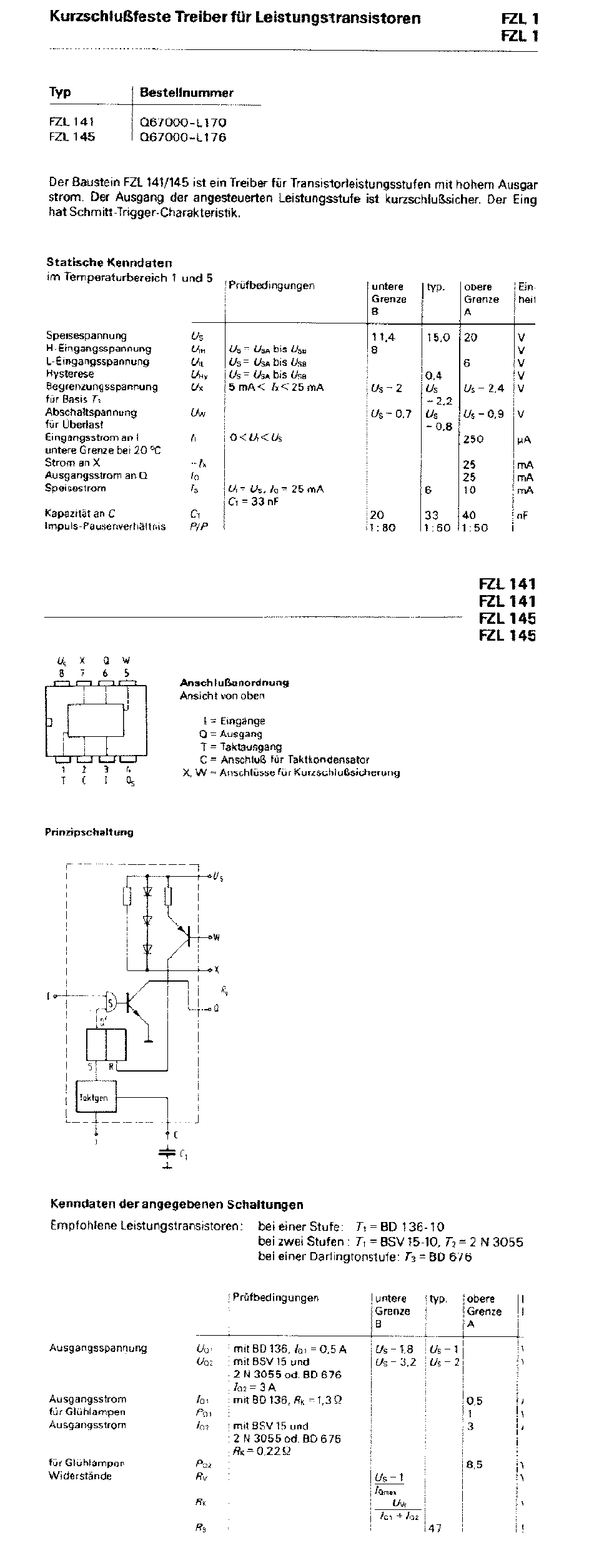

A very nige guy sent me some info so I made a small PDF file for you.
  • FZL141_FZL145.pdf
Here is the GIF
fzl141_fzl145-gif.8444
