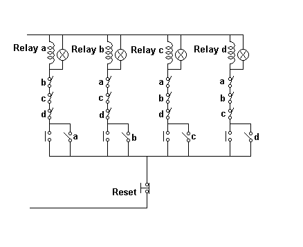

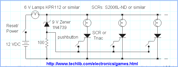

I need ideas on a realy for our childrens church. What we have in mind is a number of buttons and lights set up to tell which one was pressed first. Thank you for your help.
You can try the following circuit. There are more information on the link.
Game Show Timers
