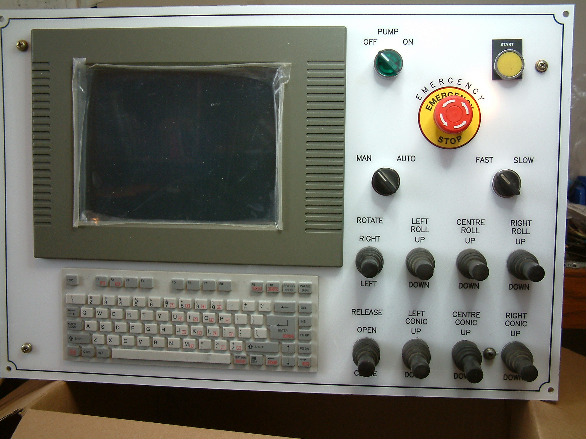

There are manuf of buttons that supply transparent covers and simple clear mylar in a printer can product the legend.
What I tend to do now is send in a file to to local Lamacoid engraver, they do reverse engraving which means that multi colour legend can be made with no grooving or etching of the front face at all for a complete panel face layover.

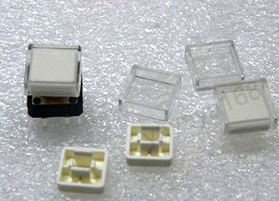

Square buttons with clear snap-on caps are available in many colors on eBay. If you print the legend on transparency matertial, the key color will show.

The key switches I have used are cherry mx mechanical pc keyboard switches and I don't think the key covers for standard switches will fit.
