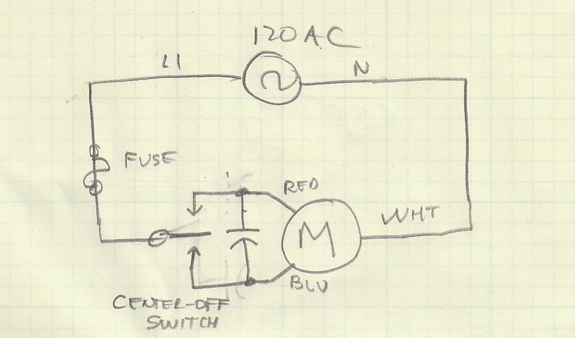

I'm new to the forum - need your help with a question about a garage door opener electric motor that I removed from the Sears Lift Master opener.
Unfortunately I did not note the wiring before I disconnected it all (initially I had no intentions of saving the motor, but then I had second thoughts).
THe motor is rated at 115V - it's Chamberlain. It has three wires: white, red and blue. Connecting the power directly to white and either red or blue wires makes the motor humm, but it will not spin. I thought that maybe it needs a starting capacitor to get it going, so I hooked up the saved capacitor (230V 53-64mFd) in series with the blue wire and connected the white cable to the white lead of the power cable - it made a softer humm but still it would not start...
Measuring resistance of the three wires between the following pairs:
Blue and Red - 7.8 ohms
white and red - 3.2 ohms
white and blue - 3.2 ohms
How should these three magic wires be connected to make this motor run... :) Help me out plz -

Based on the resistances, I would hook it up like this:
The no-capacitor winding has to be powered in parallel with the one that has the capacitor in series with it.

I'm with mike.As a general rule, single phase cap start/run motors have a higher impedance (resistance) on the start/auxiliary winding and a lower impedance on the run winding.The idea is to hook them both up in parallel, but with the capacitor in series with the start/auxiliary winding before the parallel connection to the common. This creates a phase shift in order create another slightly shifted magnetic field, allowing the motor to rotate, otherwise as you have already discovered, the motor will just hum, because the magnetic field is stationary. Hope this simplified explanation helps.:)
Mikes diagram and colours are correct for a Sears GDO motor. White is common with the colours being up and down.
As well, these motors have a built in thermal cut-out in series into the common windings
Worked!
Hooked it up last night according to the diagram from Mike - worked like a charm! Fwd and Rev - working great.
Thanks very much you all - for your advice and suggestions.

I am trying to follow your drawing, the switch wiring from the capacitor to the switch, red and blue would connect to the black hot lead with the switch moving left or right for right rotation or left rotation.
I would say it differently; in the USA, the Black wire (120Vac power feed, L1) would connect to the common terminal of the center-off switch.
