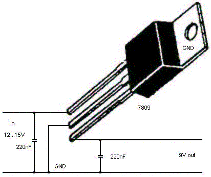

Perhaps a 7809 voltage regulator would be a safer bet, little more expensive than a resistor but will be unaffected by changes in the input voltage from car electrical system.

No thinking about resistor and zener. The regulator give safety.
Sebi... where do i get that? can i buy it at radio shack? do i just ask for 7809? Now that i've seen a picture of it it looks pretty simple. Thanks again

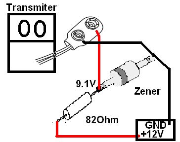

The 7809 is also a good idea. You can find a 7809 at Digi-Key here in the US, but the inconvinient part is that you are going to pay more for shipping and handling :lol: Here is the part number you want: Digi-Key Part Number NJM7809FA-ND
The Zener will work as well and would be faster to build. You just connect a 82 ohm 1/2W resistor to the 9.1V zener 1W and voila! If you wish to add protection you can always put a fuse in there a 0.5A fuse will sufice
The best is that you pick up the LM317 at Radio Shack
Good Luck,
Ivancho

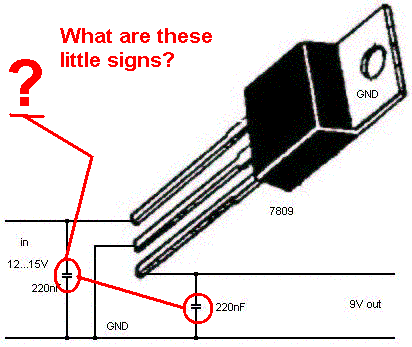

the "little signs" are capacitors
they are kind of like little electron buckets that stabilize the device
nf means nano farad
there are 1000 nano farads in a micro farad
a farad is too large of a measurement for most common devices
micro farad is often labeled uf or mf
nf is a way to label micro farads without using decimal points
my diagram shows .01 uf which is 10 nano farads
the value isn't too critical
I used that size because I noticed they were cheaper at Radio Shack
it is all terribly confusing until one gets use to it
