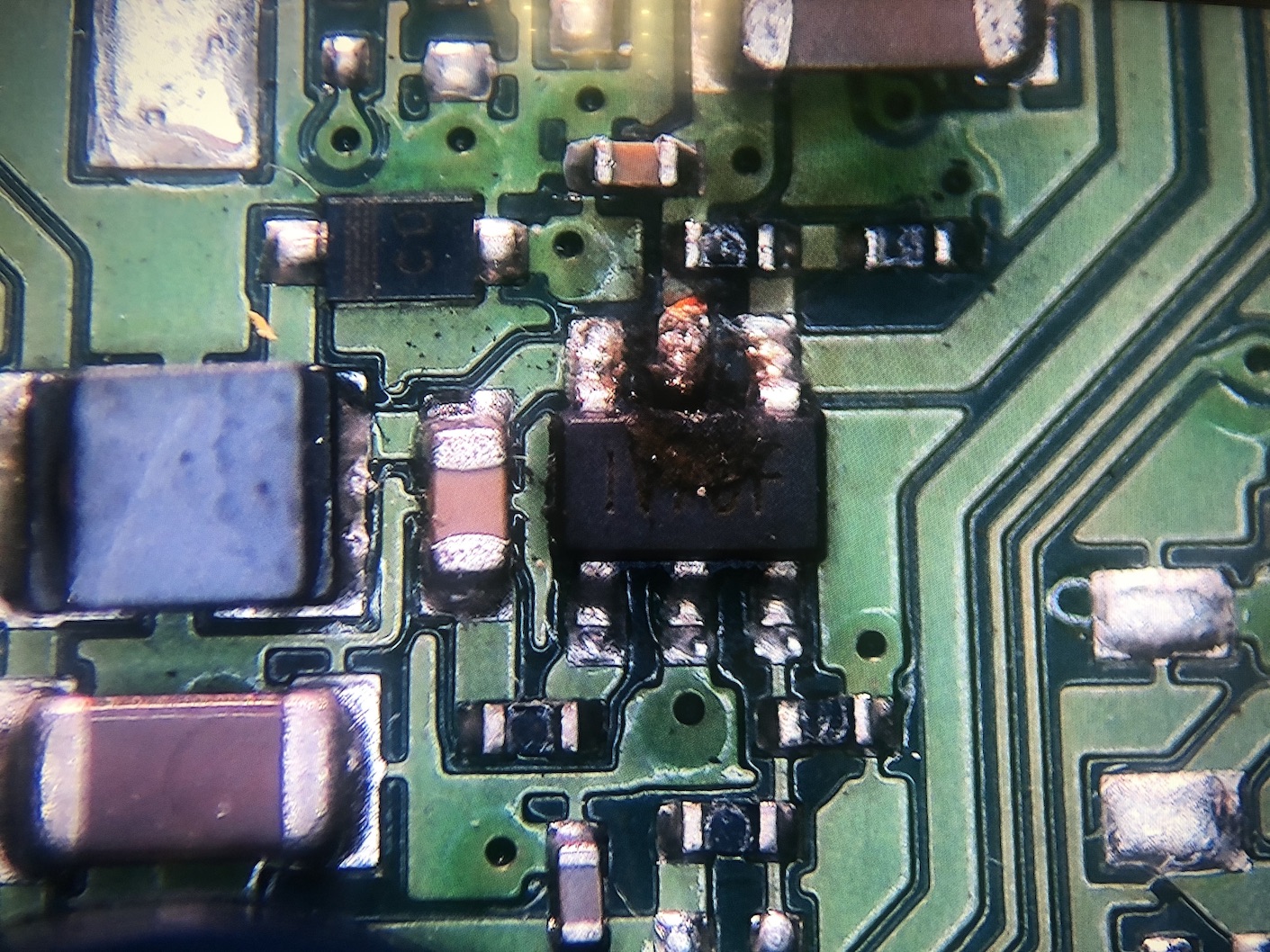

I am busy repairing a Garmin Echo 101 device that has a blown IC.
The only information on the IC is IV7DF. (See attached foto)
I am not able to find this component or any replacement.
Are you perhaps able to assist me to identify the component or a possible replacement?

Switching regulator made by MPS. You may have blown resistors chips but should be able to guesstimate from the datasheet. MP2451
