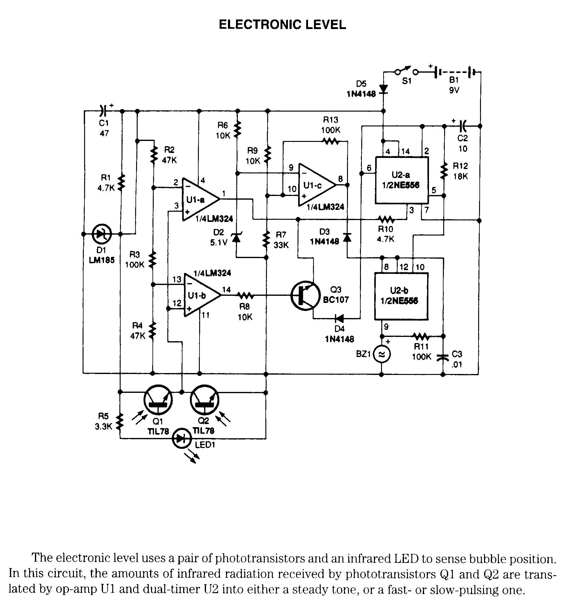

I am currently doing my Major piece of systems and control coursework
(for 15-16 year olds) and i was wondering whether i could make an electronic level.
I searched the web and found a schematic (attached) but i think it might be out of my league.
Could you please take a look and give your opinion.
THANKS
Ps You can also see the schematics at the following address:
https://circuitos.tripod.cl/schem/r57.gif
