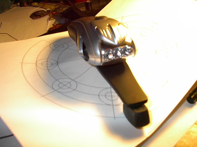

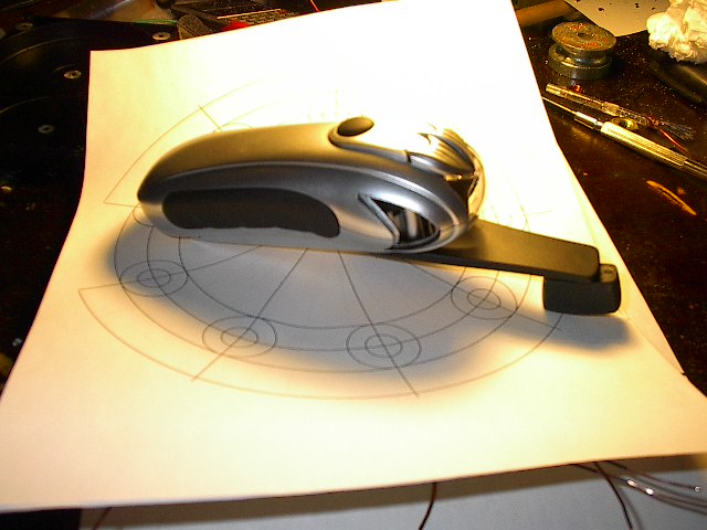

its got three , sort of bright ( by luxeon standards) white LEDs..
and a rechargable Li-ion cell and a little motor/generator putting out dc , into a full wave bridge rectifier..

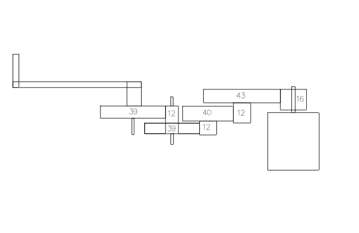

AND a 94 : 1 gear ratio.. :lol:

After checking the crank's short circuit current and looking up the battery capacity, I found the charging abilities of that generator appeared greatly exaggerated. Without recalling the numbers, it would have taken an excessive amount of crank time to charge the battery and at the normal power for 3 LEDs it could drain it in a pretty short time. Since LED current goes down as the battery discharges it would take a really long time to actually run the battery down entirely but the period of useful LED power is rather brief.

Of course , thats the first thing i did too ( took it apart)..
then i let it run down ( by leaving it on ), surprizingly it took all night to to run down initially..
your right that once it is run down ,and after a short crank , it only stays really bright for a few mins. but you can just crank it up again..
Anyway i want to use the crank and gears for my new generator , i think it will work..
