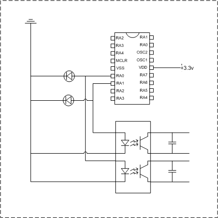

So I assume then that for this circuit attached, set HIGH would turn the LED's and opto-couplers on and set LOW would turn them off ?
I'm just checking just encase it doesn't work like this :)
Sorry for the visio diagram, really need some other software.

That should work with a couple qualifiers;
(1) You probably should have current limiting resistors in series with each LED and optocoupler.
(2) PIC I/O pins can sink a little more current than they can source and I suspect that's one of the reasons 'sink' switching to ground is used more often than 'source' switching.
Good luck. Mike
Yes, but you need those current limiting resistors so that you do not exceed the PIC's max current out per pin/port spec and so you don't blow the LEDs.
FWIW - A lot of circuits work 'backwards' and use their I/O to ground the circuit (sink) rather than use their I/O to provide the +V (source) because a lot of devices can sink more current than they can source. That PCF8574, for example, can only source (at max) 300uA, while it can sink (typ) 25mA.
Rick
If you use the PIC16F84, as you said in your first message, then you can't use a 3.3V power supply. You need 5 V.
