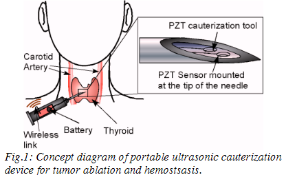

I'm working from a paper where they describe using a PZT element to cauterize tissue (my application is quite different, but uses PZT to generate heat); but it is somewhat confusing. In one part of the paper they show this diagram:
Here, very clearly the PZT elements are 3.2mm round and 190µm thick.
But in another part of the paper they have this diagram where the PZT element(s) are embedded into the side wall of a hyperdermic needle:
If that needle is large enough to embed a 3.2mm diameter PZT in its sidewall; I'd drop-kick any doctor that approached me with it in his hands. Geez!.
Update: To get the proportions of the diagram above the needle would need to be 10mm in diameter:
Into your thyroid?
Cardiac ablation is normally done via catheters inserted in both wrists, and positioned in the heart - one is for monitoring, the other does the ablation. So obviously it has to be small enough to be inserted in a vein, and pushed through to the heart. This is essentially the same technique as an angiogram or the fitting of stents.
However, I suspect it's not as small as you might hope for :D
Even assuming it's 3.2mm for the PZT above, I don't see as that's an issue as it's there to try and save your life! - and they would inject local anaesthetic first, and perhaps even cut a 'hole' for it. I imagine there's probably a lot of procedures that use that size, and larger, needles.
I knew RF heating was used, but can't say I knew it was via a PZT - or had even thought about it.
