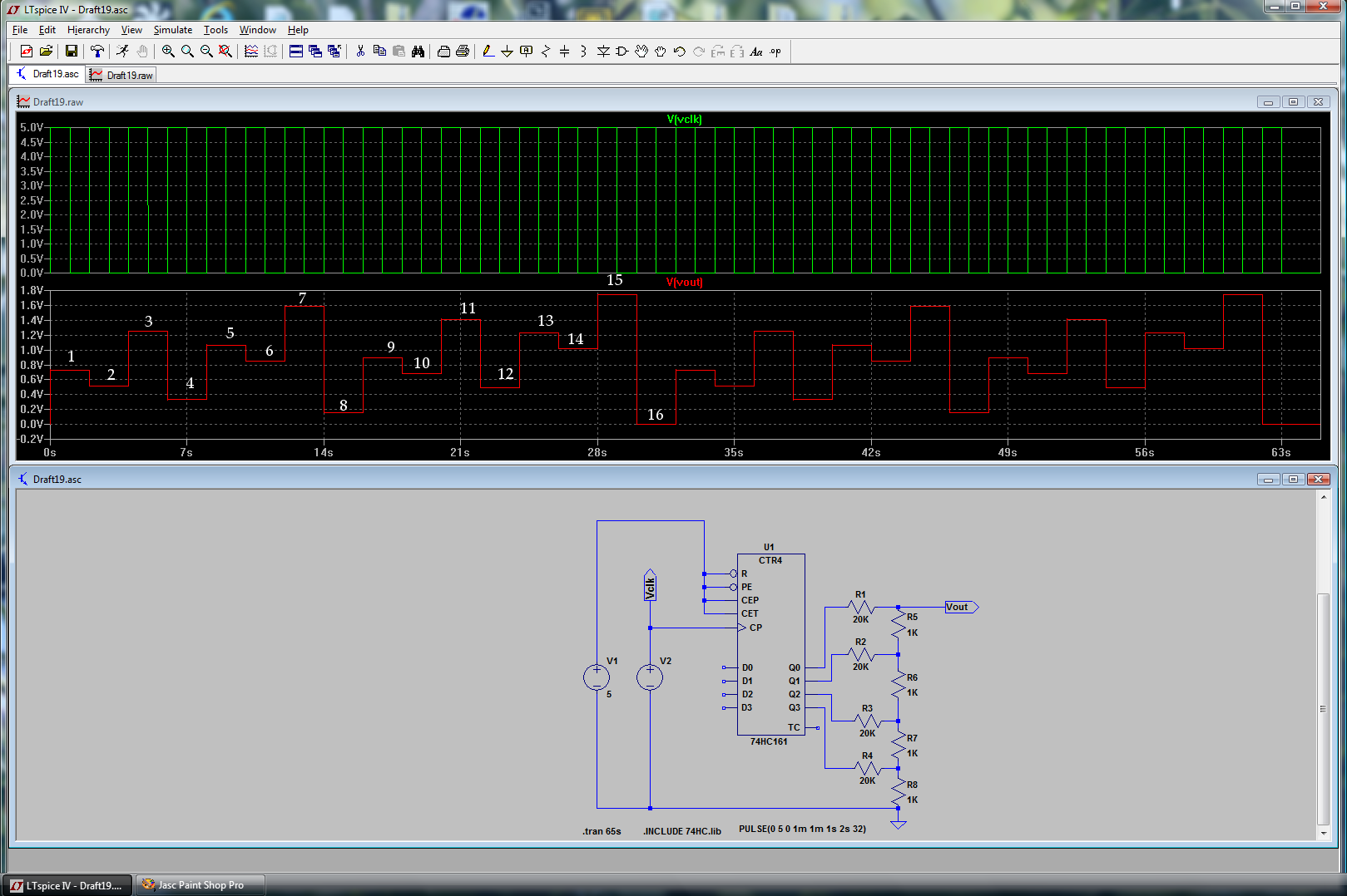

Using discreet components you could use a chip like the 74HC161 configured as a ramp synthesizer which when clocked would produce 16 outputs. If you fast clock and stop the output will be a random voltage between 0 and whatever you set the resistors for. It would use 8 resistors. You would randomly get one of 16 possibilities between 0 and 2 volts. I am just not sure exactly what you want? There are a number of ways to do it using discreet components without a high parts count.

Sorry for being so vague. The output of the random voltage generator will drive the input of a driver IC. Depending upon where I insert the random voltage, it could be in the range of 0-100mv or preferably .6-1.1V. There isn't any timing circuitry in the device so interrupting an IC like that isn't ideal. I don't need too many discrete values for the random voltage and 16 would be more than adequate. Do you know of anywhere I could find these numerous discrete options?

The best I can suggest using discreet components would be along the lines of the attached image. V2 simulates a clock pulse. The likely ideal way would be using a uC as was suggested. Each time the chip is clocked a different voltage appears at Vout.

You could use a counter clocked by a fast clock, plus a latch to latch the count when enabled by a slower clock asynchronous with the first. Use weighting resistors to convert the latched count to an analogue voltage.
