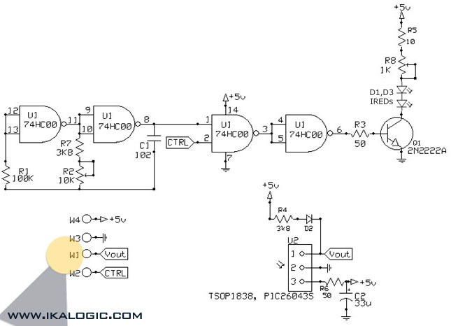

the sensor is controlled by a microcontroller to generate the low duty cycle pulses, you can benefit from the High and Low pulses to be able to detect any false readings due to ambient light. This is done by recording 2 different outputs of the sensor, one of them during the ON pulse (the sensor is emitting infra red light) and the other during the OFF time. and compare the results.

hardware connections:
1)LED connected to PIN RC3 of micro controller;
2)IR receiver IC TSOP48 has a digital output that can be directly modulated by a micro controller. The output of the IC is on pin 1 of the IC. The output of the receiver IC is connected to pin RC2 of micro controller.
3) microcontroller generates low duty cycle pulses at pin RA2 at 40KHz.
RA2 is connected to the CONTROL input which is linked to a transmitter
the CONTROL input is connected to the source of low duty cycle pulses which could be from a 555timer but im not using a 555timer. i want to use the PIC16f690 to do that.

i am a beginner. need some assistance please for my project.
i am generating low duty cycle pulses from the microcontroller to the transmitting infrared LED.
i want my project "infra red proximity detector" to be immune to ambient light.
AIM:
when receiver detects an object then the LED must light up.
when it does not detect an object, the LED must not light up.
ambient light such as a desk lamp can falsely trigger the receiver.
when i shine light onto the receiver i want the LED to remain off.
when i programed the chip and put it into the circuit. The LED pulses but i dont want this.
could some1 please assist me.
Hi do you want to read that IR module (TSOP) from the micro controller from the reflected IR signals from the transmitting IR LED?
Actually you need to define a protocol when dealing with IR modules.Otherwise any consumer based IR frequencies (38Khz,40Khz,56Khz) will trigger the IR (TSOP) module & you will see the output toggling :)
here is the circuit Blueroom
Yes Gayan Soyza, thats what im doing for my project. I didnt define any protocols. Uhmm didnt know i suppost 2. How do i go about doing that ???
