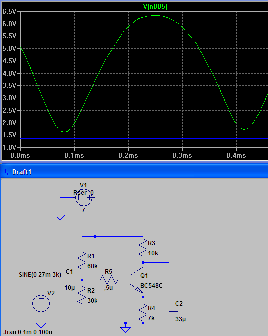

generating even harmonic distortion...
A rectified signal is full of even harmonics.
A JFET produces a little amount of even harmonics, maybe 5%.
What do you want to do with them? Do you want distorted audio, or...:confused:
Yeah, distorted audio but max even harmonics, minimum odd. It's for a 4 band EQ. I'm trying to get a tube sound with solid state parts.
A vacuum tube smoothly produces about 5% even harmonics distortion. Because the harmonics are smoothed then the high frequency harmonics are not produced.
A FET will sound similar.
An ordinary transistor produces severe even harmonics distortion when the output is fairly high, it has no negative feedback and the input is fed from a low impedance source.
