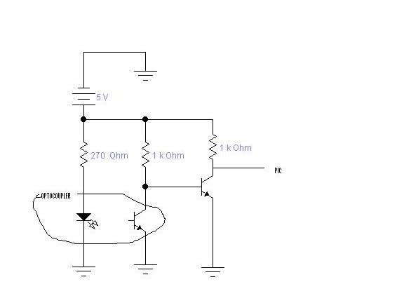

im thinking of making somekind of meter to gauge my motor speed . I cant seem to come out with anything good though. Any recommendations?
my motor power supply is 12V. I am of thinking of sending the speed readings from the PIC to the PC. 12V seem to high to enter the ADC channel. thats was why i was considering the motor/generator.

Right! - so you're wanting to measure the speed of an existing motor!.
As you've already suggested, you could use a DC motor mechanically coupled, and this will give avoltage ouput proportional to the speed - but it's rather a complicated way to do it.
An easier way is to generate a pulse (or number of pulses) per revolution, you can do this with a slotted disk and opto-sensors, a disk with small mirrors and a refective opto-sensor, with a magnet and hall effect devices. There are many different ways!.
VCR's often do this in number of places!.
You simply use the PIC to measure the time between pulses, then you can calculate the speed with simple maths.

Just use a voltage divider and it is no problem to read this voltage into the PIC's ADC.

i finally decided to use an optocoupler to measure my motor speed.
I will be design my own disk with a certain amount of holes in it.
I thing im really blur now. How do i calculate the rpm using this technique. Is there a standard formula?

The number of revolutions per second is simply 1 / time per revolution. So for more than one hole it becomes:
1 / (time between holes x number of holes)

There are various ways, for a start you can use a simple software loop to count the interval (which is what my IR tutorial receiver does), or you can use the timers in various ways, or interrupts on change on PortB.
There's an old application note at MicroChip for a 50MHz auto-ranging frequency counter - at high frequencies it counts the pulses, at low frequencies it measures the pulse width.
You might be interested to know that STAMP BASIC (and most PIC BASIC's) have a "pulse in" command to measure the width of a pulse.
since im still a beginner, i just want to confirm whether my optocoupler circuit is ok. Everytime when the optosensor is blocked, the output to the PIC would be LOW. When it is unblocked, the output would be HIGH.
Apart from that, im just want to make sure my concept is right right for PIC counter. First of all, i will write a program whether the PIC will continous check the PORT pin to see whether is it HIGH or LOW every 0.1ms (in other words, 0.1ms is my sampling time). If it is LOW, then i will increment 1 into a variable register. Once it detects it is HIGH, then the data inside the variable register would be transmitted to the PC and convert it into RPM using the equation Nigel recommmended above.
Is the concept right :?: :D
