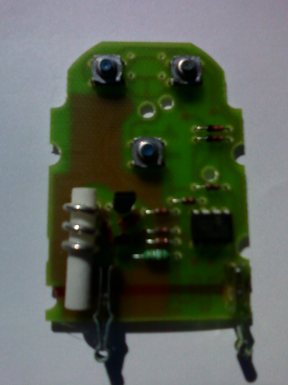

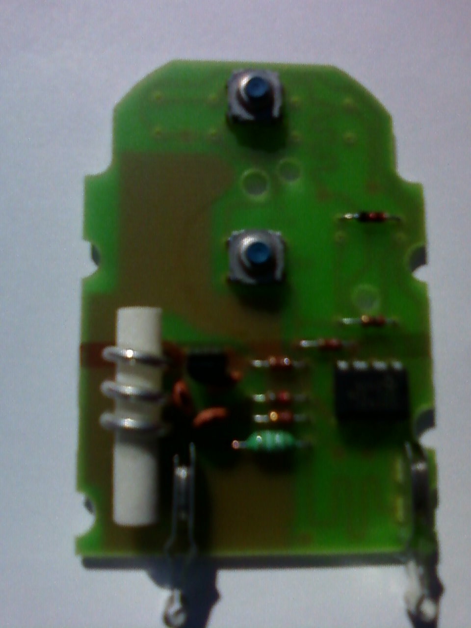

has anyone converted a type 3 intellicode remote to a type 2 intellicode? i have several remotes and all will not work with my garage door its a type 2. i am looking for some diagrams and info on how to convert them.....just by looking at the 2 boards, seems all i have to do is remove a resistor,,,,but not sure, can anyone help?

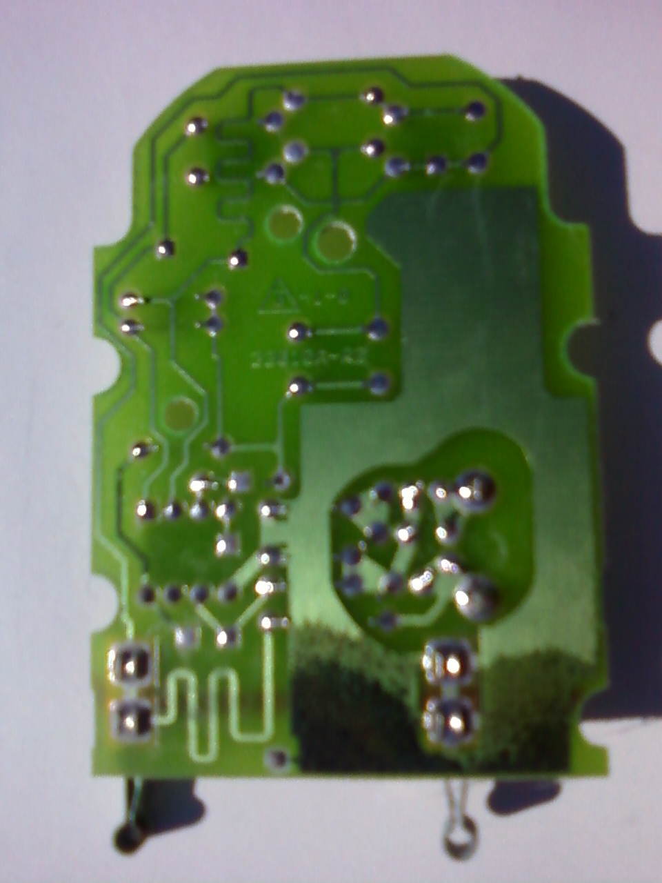

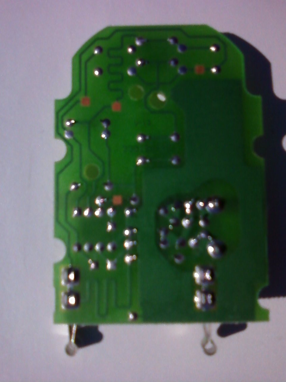

i think both are rolling codes, the boards used in both remotes are the same. they are just using different routing in the circuits, with 1 extra button and resistor. i am trying to change the type 3 to a type 2. i attached pictures of both boards front and back.

They certainly look similar, and it is easy to see how the switches can be rearranged. I can't tell from the image whether the extra "resistor" is a resistor or diode. If it is a diode it may have a glass case. Resistors will have colored bands.
The big risk is that the microcontroller(?) program is different for the two types. If that is the case, you will probably not be successful in the conversion. I assume they are tuned to the same frequency.
Given the low prices of these things, I would be tempted to just try the conversion ( type 3 to type 2) and see what happens. Even if it doesn't work as a type 2, it may not be destroyed as a type 3 by doing that.
