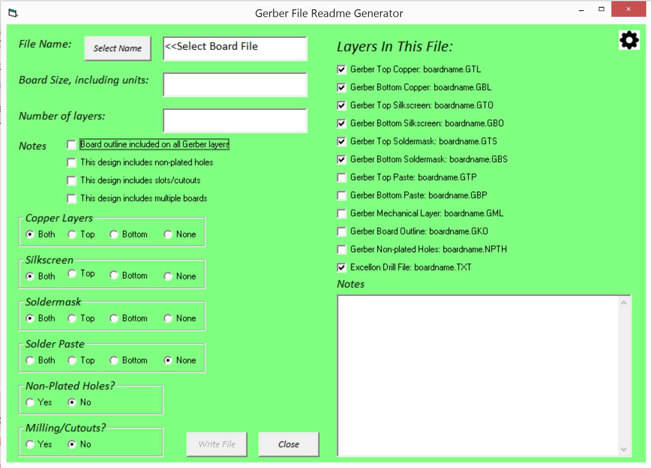

This screen shot shows the Gerber File names in accordance with what most of the Chinese fabs want. I believe that Dorkbot/OSHPark recently changed to the same convention. I only recall needing a separate board outline layer once - that may have been with Dorkbot. These are the names I use for my orders with Elecrow
I always include a readme file that shows what each of the layers is, and also include notes that the board outline is on every layer, if there are non-plated holes, milling, etc. As long as all the required layers are identified and included, most fab houses will figure it out.
Note that the Gerber File standard doesn't specify layer extensions - the naming conventions come from layout software and what board fab house want. This list comes from reviewing what many fab houses want. I spent some time researching this to include different conventions in my readme generator program; that research showed this was the common standard amoung Chinese fabs and it's becoming very widespead. Beyond this, I didn't find any other widespread standards.

I will get everything together and post it here for sure. It's a handy program for making the read me files which can be a little tedious.

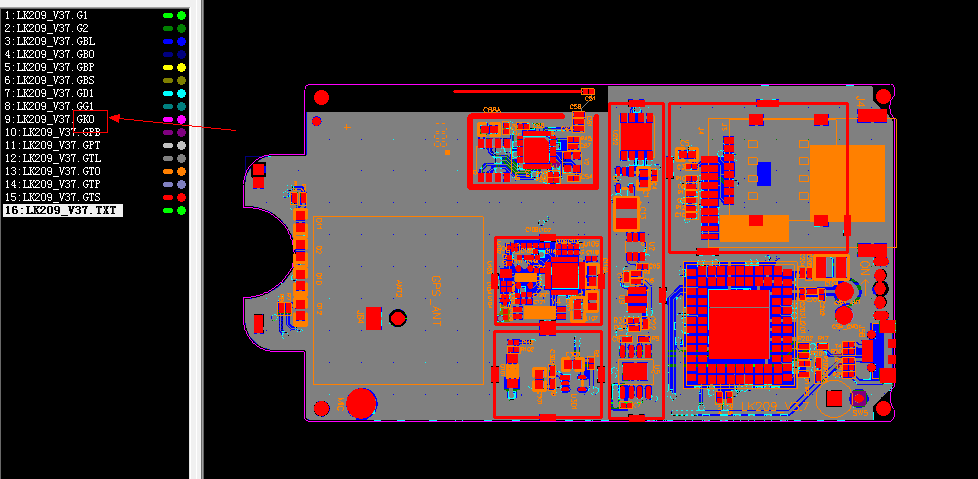

no matter what software you use, and all files designed by it should be converted to gerber files for PCB production. And the gerber outline file extension is .GKO (gerber keep-out layer).
That is only one of countless ways to do it. Not all software packages use the keepout layer for the board outline.
