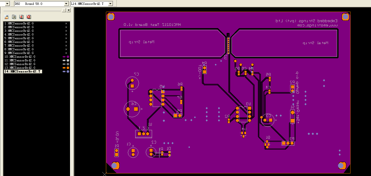

Hi ALL,
I had to use Altium designer 10 for a PCB design, generated Gerber files and i see through holes misaligned . I used all standard options for generating gerber i am confused what went wrong , see pic attached . when generating both gerber and NC drill files my units : inches , and format was 2:5 Any clues ?
Looks like its just mirrored. Did you click any "mirror plot" checkboxes anywhere?
