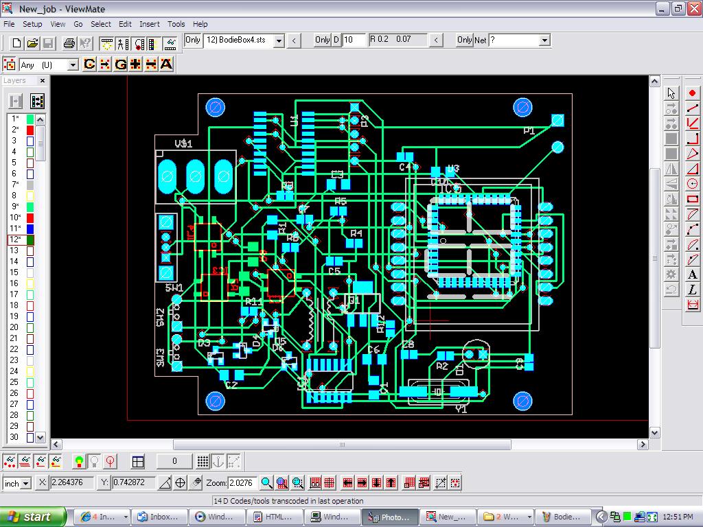

After you make your gerbers in Eagle you can download "Veiwmate" for free to check your gerber files.
