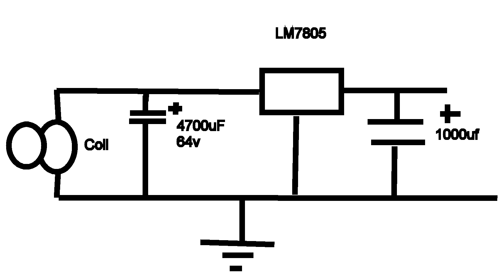

I just had an idea to put in some LEDs to control traffic on a steep road where I Agist my horse.
My first thought was a car coil with the high tensin commectd to the fence, common ground
Has this idea got merit to go further:confused:

A seperate battery would be much easier to use then trying to use 50,000+ volts from an electric fence. The current the fence puts out is going to be very small anyway, else it would kill people and animals that touched it. Its not going to be able to power much of anything. Most fences I have seen are also pulsed, not on steady, but pulsed at a low duty cycle. This will cut the power it outputs even more.

Another problem is that the fence's supply probably has a very high impedance so connecting any significant load to it would drastically reduce its effectiveness.

is the electric fence AC? If it is 50/60Hz, the automotive flyback will saturate so it wont work.

Electric fences usually work off 12V lead acid batteries, and provide intermittent HV pulses to the fence - in a very similar way to a car ignition coil.
on the fringe of the city
the fence is powered through 240v to ht pulsed output. the idea is the reverse of the normal operation of the car coil.
A rapidly changing magnetic field induces a voltage into coil and this is stored on a cap then passe onto the capacitor. I will try in the next week as a matter of interest
We do understand what you are trying to accomplish, but the problem is the electric fence is usually always very low current. There has to be enough current in the coil to produce a good magnetic field before it will produce any kind of usable power.
