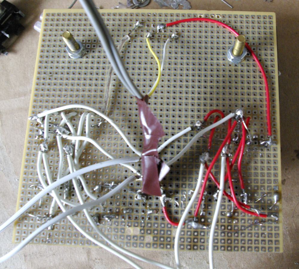

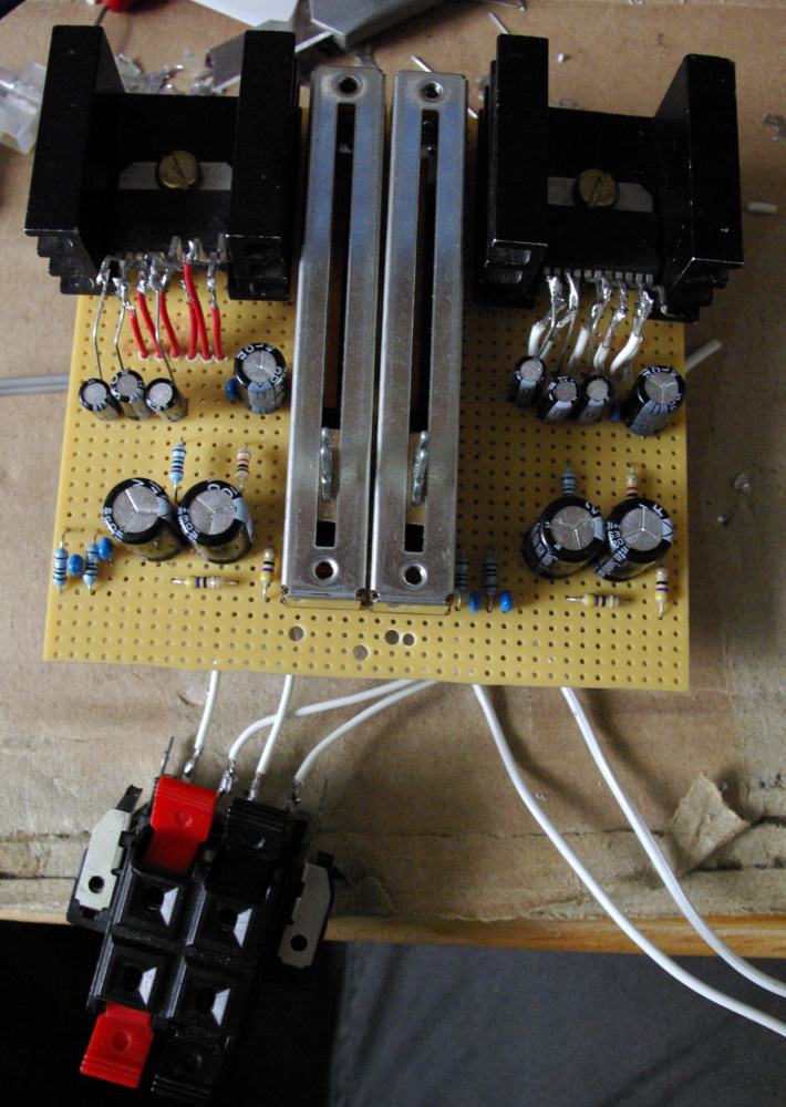

yes its oscilating at 6 MHz with a 4.5 Vpp output, any way I can stop this ? I can't understand though why its getting hot with no load on it as there is nothing to draw power, or is it that the internal circuit is running faster than normal and generating the heat ?

It's getting hot because it's oscillating - layout on many audio chips like this is really pretty critical in order to get it working.
Post a picture of your layout.
well picrtures: yes its quite a mess....
Yes - not surprising it's unstable :D
If you check the datasheet, you will notice it gives a suggested PCB layout, most datasheets don't do this - but when they do it's a good indication that layout is critical.
Mounting the chips like you have and extending their leads is a bad idea to start with, all connections need to be as short as possible, and the tangled leads underneath are a further source of positive feedback, which is what makes it oscillate.
