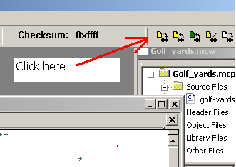

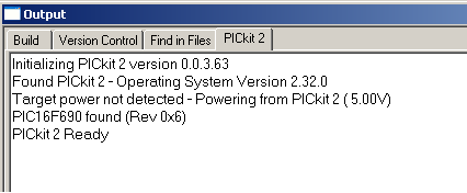

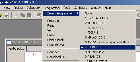

Hi Nick,
The attachments below should help you get from compiled and hexed program into PICkit 2 and your uP.
After you get a successful build (shown in output window) then select programmer and Pickit 2 (Help_1)
Output window will change to reflect Pickit 2 is located and ready (Help_2)
Then click as indicated in Help_3, and you should get a notification in the output window of successful transfer.
Hope this helps
edits: correct spelling

Hi Nick,
Hope this helps

There is no need to "release from reset" or anything other than what I have given.
