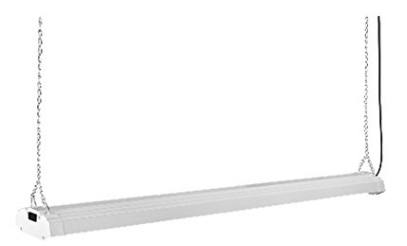

Do those happen to be "linkable" shoplights like this:
Mine are Hykolity brand, but I assume the same thing is sold under different brands. They are connected to each other by 2-prong plugs.
When you say "one circuit," I assume you mean one, 110V feed from a single breaker and there are no feeds from other breakers in the shop. Correct?
I don't believe in ghosts. But I do believe in ghastly wiring and unintended shorts.
the fixtures are similar as per picture, all daisy chained using Female plug to next fixture. 4 fixtures with the culprit fixture as the last in the chain (need to check this today anyway) and being different brand fixture. could be the male plug just needs to be turned around??
