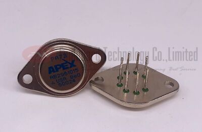

Did web searches, nothing on datasheetarchive or NTE site.
Any info anywhere?

Quite likely the equipment makers in-house part number; that used to be very common.
What is it in - can you trace the connections?
A lot of large companies got equivalent parts from several suppliers, but had them all marked with their own part number, so the number does not tie in to a manufacturers part other than in their own records.
That mean a single part ID during assembly, to avoid confusion - however the number is otherwise meaningless.
You will have to trace the circuit it is in, to figure out how it's connected and what it does.
There is a slim possibility a "real" number is marked on the underside - that was not unusual with in-house logic ICs etc., but I have no idea it would apply to a TO-3 case...
This is an example of a less frustrating in-house numbering - the equipment makers part number over-stamped rather than replacing the chip makers part number:
As others have said, it's almost certainly an in-house number, so there will be no specifications available for it - and the only people who could tell you what it actually is, are the manufacturers who ordered it with that number.
I wouldn't go as far as even a 'slim chance' of it been labelled underneath, as I've never seen one that was - and I've replaced a LOT of in-house components over the decades. Luckily, at least we had the service manuals, and while it gives you no details other than the in-house number, it's relatively easy to work out a suitable replacement if you have the circuit.

It could be an LM-12 or something like one of the others below, as it appears to be the only power device on the PCB??

Flip the board over and check the number of pins - if there's more than two, then it's an IC - but TO3 IC's are pretty unusual.
I see JRW has posted while I was typing, and it makes sense that's it's an (old) power opamp, rather than an actual audio amplifier, which would also explain the 16 ohm speaker.

Eight pins
Pin 1 is B+ pin 8 is B-
Pin 5 output wired direct to the speaker

I've had another thorough search but so far I've not been able to find any device that matches that pinout; most have power & ground on 3 & 6 or 2 & 7, with 1 as the output..
It's quite possible the data for that was just never scanned & only exists in old databooks - or its a custom IC.
