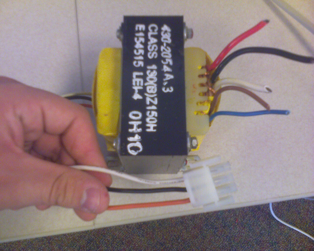

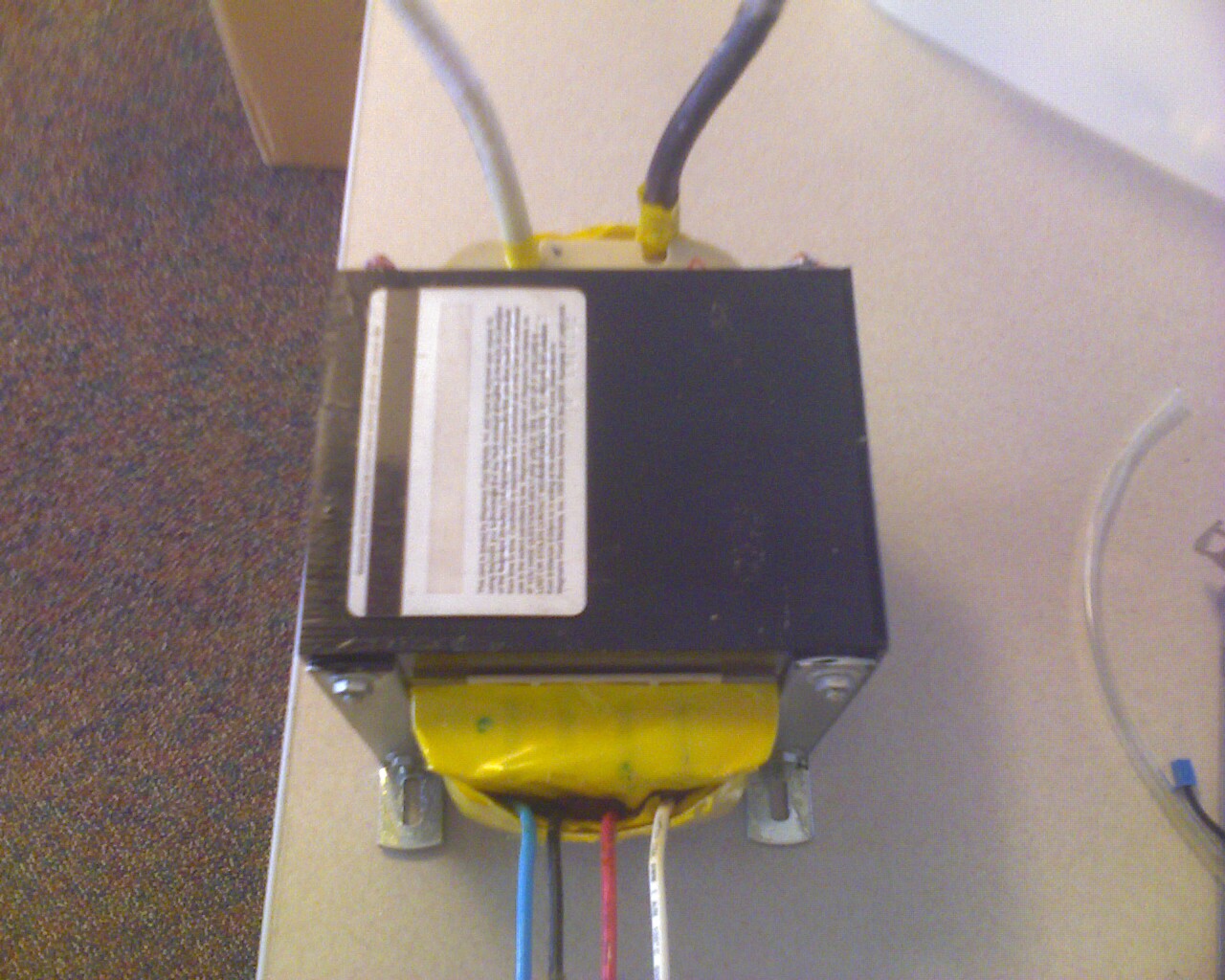

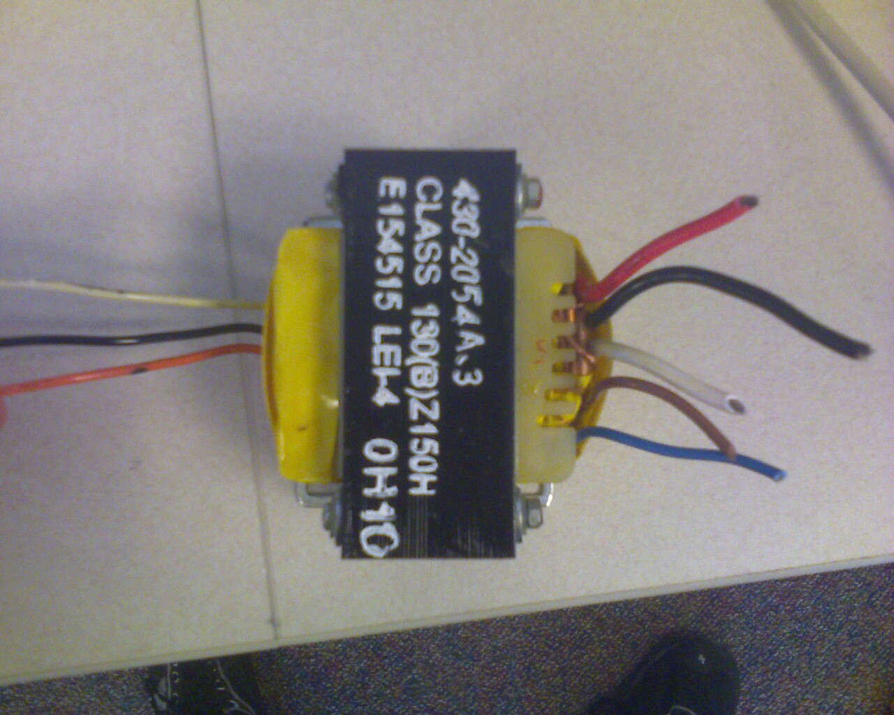

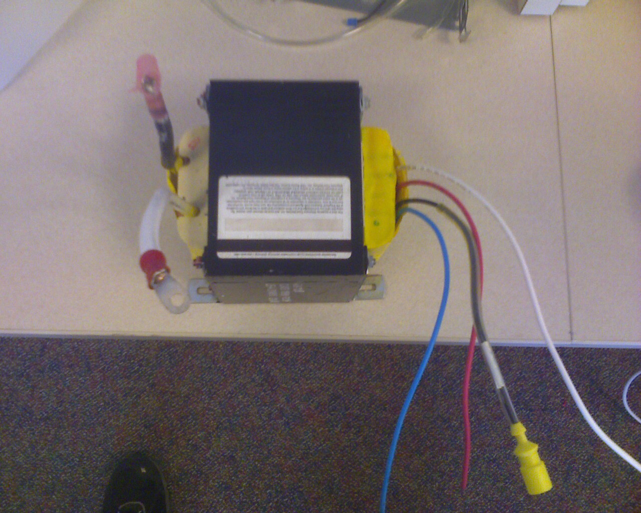

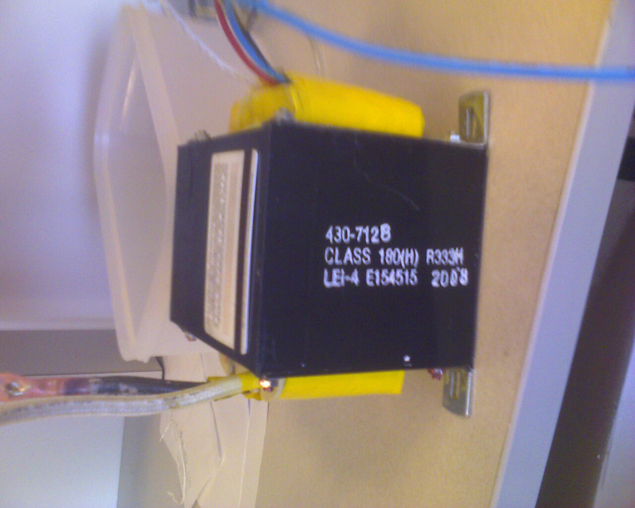

I got up to the lab today and snapped some photos. There are two transformers here. One is quite large (there is a credit card on top for size reference) and I am sure it came out of a UPS. The second is probably from a smaller UPS but I cannot be sure, as I just found the transformer by itself.
The first 3 photos are of the large transformer, the rest are of the smaller.
I have another transformer in my apartment that I can take photos of later. It has 4 leads, all on one side, and is sized somewhere between these two. The 4 leads all go into one plastic connector.

Doubtlessly gigantic transformer: big is beautiful.
Starting with the smaller transformer, this is definitely a step-up transformer intended for inverter (UPS, the more sophisticated application). The cables on the LHS terminate to secondary windings, should be capable of delivering a peak of 325V between the white and orange cable. The black cable should be an intermittent tap, often used for voltage correction. The cables on the RHS terminate to primary and fly-back/ utility windings. The red, black and white cables corresponds to 12-0-12V winding (24V center tapped winding). The brown and white cables should serve as fly-back or other utility.
The above was an approximate evaluation. For detailed analysis, proceed as follows. Determine and note the continuity/ closed connection between the cables with a continuity tester/ ohm meter. The result will reveal the connection of coils. Determine and note the inductance of the coils with a inductance/ LCR meter (assuming you can reach to the equipment). Calculate the AC impedance of the secondary windings (between white-black cables or white-red cables, whichever is greater) at frequency f = 50Hz. An impedance greater than 1000Ohm will assure the safety to connect the secondary to 240V mains to obtain stepped-down isolated voltage at primary.
Incapacity to find an inductance/ LCR meter will invite indirect method of determining inductance with a signal generator (function generator, waveform generator or audio oscillator), AC millivoltmeter and ohm-meter which will be discussed on your report.
To set-aside the analysis and proceed with a project, I will recommend you build an inverter, which will be discussed on your request.
Wow, thanks again for your expertise and willingness to help. I do not have immediate access to an LCR meter (only an LC) but I do have a precision digitally synthesized function generator and an oscilloscope, which should get the job done.
I am confused about the orange-black-white combo on the smaller transformer - you say black is probably an "intermittent" tap used for voltage correction - do you mean center tap? so that black is always halfway between then?
As for the larger transformer, what do you think of that one? I will have to get around to performing a full analysis on both to be sure.
I am not sure what I will do with the large transformer. Probably an inverter, though I do not have a need for one at this time.
As for the smaller transformer, if I determine it to be possible, I would like to build a linear power supply for my lab bench. So I will use it to step down mains voltage to 24V or so. I may also use it for a high power audio amplifier, but the voltage may not be high enough for my needs. A lab bench supply would be more practical.
