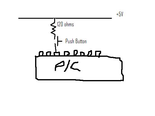

Nigel,
Can u check the attachment to see whether i can connect a input to the PIC as shown. If wrong could u show me how to do it ??
Thanks.

Sorry, but I don't do C, and I don't use the 18F series, so I can't really comment on that.
But you only need to enable the weak pull-ups if you want to use switches on the pins, and DON'T want to add external resistors - notice my tutorials use external pull-ups, so you can use any input port.
Do i still need to send inputs as in your tutorials after enabling PORTB weak pull ups as above ?
Please help me on this. Thanks.
Yes, you still need to set the pins as inputs - they 'should' be inputs by default, but it's important never to assume this, always set the ports to be as you want.
I do C on the 18F series.
You can (and for code clarity perhaps should) assign the RBPU bit directly:
RBPU=0;
1. The bit should be 0, not 1, the enable the pullups.
2. PortB pullups only apply to PortB pins which are inputs:
TRISB=0xff;
Then your pushbuttons should connect the pin to ground when pressed. The internal pullups only provide a resistance connection to Vdd to give each a default "1" value; you cannot reconfigure registers to make it a default pulldown to "0".
You would not assign LATB since PortB is the input port and the only port with the capability of internal pullups. I'm guessing you meant to assign LATC?
PWM can output 0 on the pin. I don't know why this did not work for you unless you provide some code. For this we need to know the contents of the TMR2 and CCP registers, the mux bit of the config register, and TRIS register for the pin it is mux'ed to.
