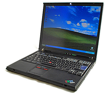

The Travelmate developed dry joints on the main board and, although the joints could have been re-flowed, it wasn't really worth it.
The Lenovo T42 was a legend in its time- and my favorite laptop. :happy:
It was in a sad sate when I was given it: full of cement dust and sand after a couple of years on building sites. The power socket was elongated and making intermittent contact and the case was scratched all over. I completely stripped it, including removing every key, and blew all the sand and cement out with an airline . I then gave it a complete clean with de-ionised water followed by iso-propyl alcohol (IPA). The parts then went in an oven at 60 deg C for 24hrs before being reassembled.
Most of the scratches polished out and the surface matted up well with fine wire wool. I reamed out the power socket and aeraldited in a stainless steel sleeve, so the power socket was then better than new. The mains PSU also needed opening up with a hot knife, and an inductor, which had broken away from the PCB- a common fault with PSUs, re-stuck with silicon adhesive and re-soldered.
Once the memory and HDD were upgraded, I used the T42 for about 18 months. It was especially nice because it had a high resolution, high brightness screen fitted.
Then horror of horrors, my lovely little laptop wouldn't boot up on occasions. Slowly the problem got worse and I found after many wrong avenues that the Cold Cathode Fluorescent Lamp (CCFL) lamp that backlit the Liquid Crystal Display (LCD) display was not striking up reliably.
After Googling possible causes I changed the inverter that produced the striking voltage and the 400V to 700V operating voltage, depending on brightness, to power the CCFL. But the fault persisted. After a lot of investigating I traced the fault to an aging CCFL and after much further Googling found a company in the USA that made superior CCFLs and, to my amazement, stocked a model that suited the T42; it wasn't that expensive either, even including post and packing from the States.
I was all geared up to fit the CCFL but then, as I have mentioned many times before, our house went up in a gas explosion, and while the T42 looked undamaged something terminal had happened to its internals, like every other piece of electronic equipment in the house. While the T520 is a far better machine, I still miss the T42. :wideyed:
