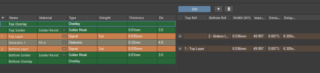

That does not show a ground plane layer? Aren't the impedances only valid if the opposite side is a ground plane?
The trace width and material thickness work out right for 50 Ohms, but only with an opposite ground plane and stitched grounds bordering the signal trace on the same side with 0.2mm lateral gaps.
With grounds a distance away, a few mm, the impedance would be far, far higher.
(No ground plane & 5mm to other ground puts it over 150 Ohms.)
