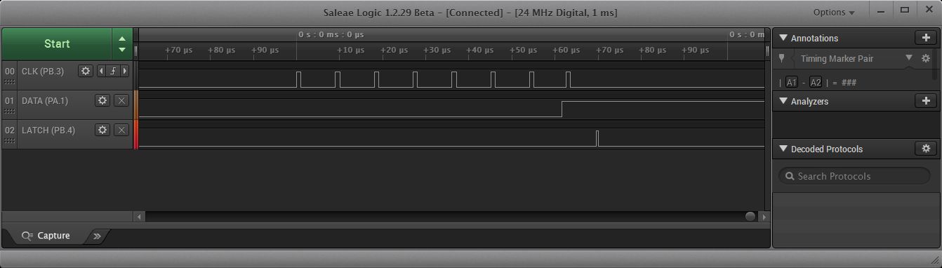

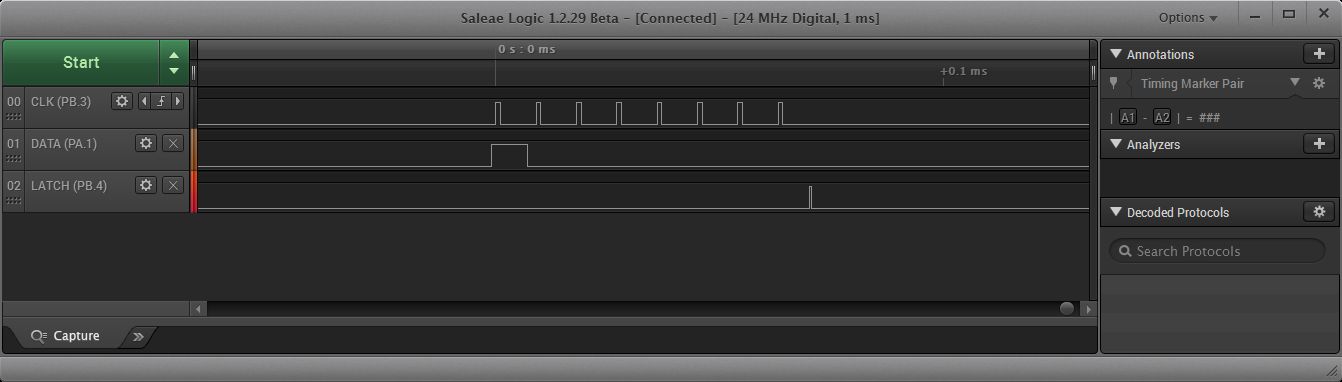

Just FYI, I compiled the above program for an 18F26K22 (instead of a 43K22), monitored the outputs of the CLK, DATA, and LATCH pins and they are as expected. The only difference when compiled for the 43 is the setup of PORTD and PORTE, so no meaningful difference.
Here's LA shots of the first (LSB) bit and the last (MSB) bits. All eight bits worked as expected.
