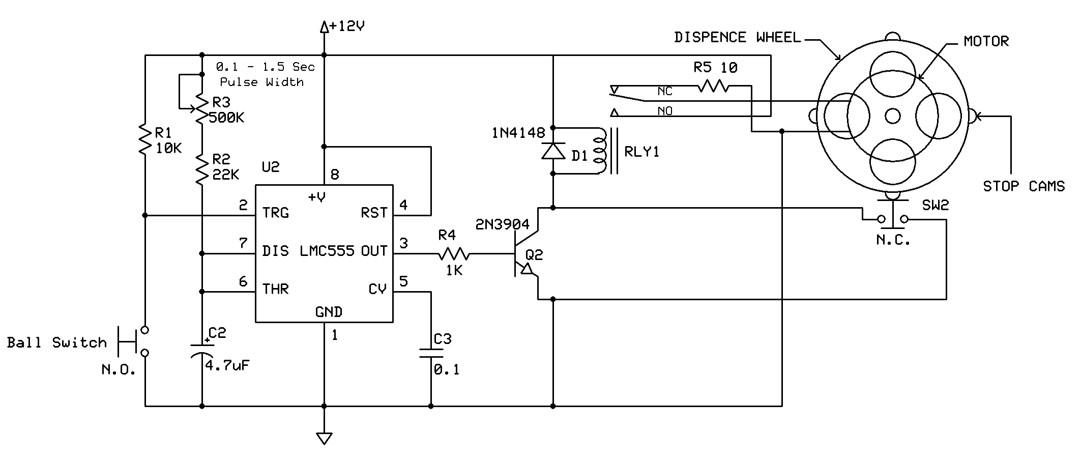

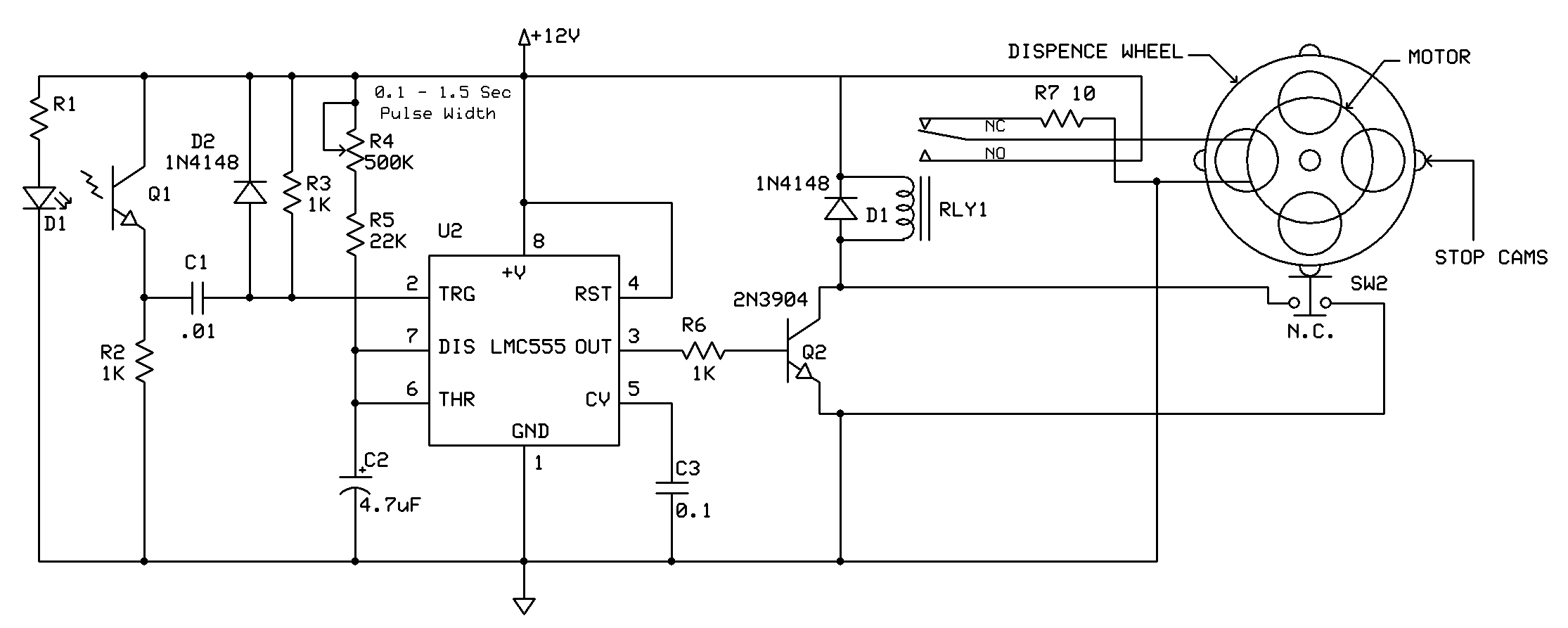

Attached are a couple of possible circuits.
The concept is that the dispensing wheel has cams that open a stop-switch at each position.
When the ball triggers the 555 monostable, it turns on the motor for a brief period, enough to move it beyond the stop-switch. With the 555 timed out, the motor continues to rotate until the next stop cam opens the stop-switch and stops the motor. The motor is controlled by a relay that either provides power, or shorts a resistor across the motor winding, braking the rotation. One circuit uses a laser pointer LED and photo transistor to trigger the 555, the other used a microswitch.
Ken
