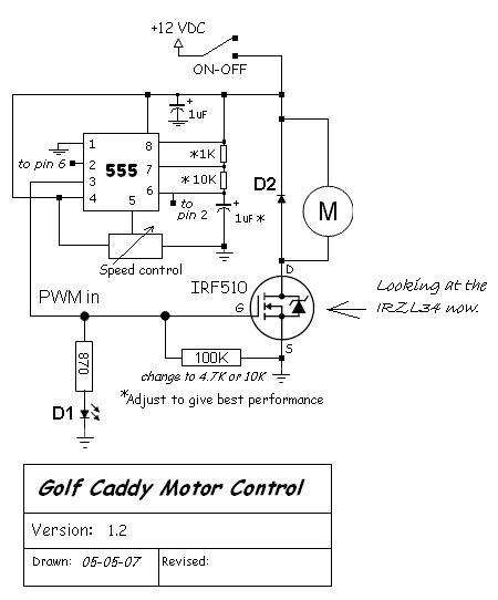

Please take a look at my project to see if I am on the right track.
I propose building a replacement motor controller that will, for the time being, simply control the forward speed of the caddy. There is no need for reverse, and I intend to add remote stop-start capability later.
The motor, battery, transmission and chassis are in good condition. Only the contoller needs replacement.
Will the attached circuit serve my purpose? I am using a standard 12-volt lawnmower or automobile battery, although I am not sure what amperage I will draw. The unit must provide easy walking speed over somewhat hilly terrain, for a minimum distance of 7000 yards.
Any suggestions or advice will be greatly appreciated.

Hi AllVol,
I would replace the IRF510 with a more modern fet.
The maximum drain current (5.6A) is too low and the
RDSon (0,54:eek:hm:) is far too high. The fet will run hot
like hell, select a more modern device to replace it.
on1aag.

Thanks, friend. Good suggestion. I'll look at some others. I just happened to have that one handy.

Yes it's critical that you know the worst case amp draw from the battery under all cases, uphill, locked rotor, etc and size the Mosfet properly. You may consider paralleling Mosfets and also consider heatsink requirements. I would suggest some kind of fuse or circuit breaker or current limiter to protect the high power components and battery.

In another thread I found the IRLZ34 recommended. Would you concur?
The Rdson for the '34 is 1M:eek:hm: , versus .54:eek:hm: for the 510. Could you explain why one meg is better than <1 in this case? I'm thinking you would want very little resistance when the mosfet is conducting. Am I backward?:confused:

Hi AllVol,
I don't know where you got those figures because the datasheet
says that the RDSon is 0,035 :eek:hm: , 35 m:eek:hm: , not 35 M:eek:hm:.
https://www.electro-tech-online.com/custompdfs/2007/05/irlz34n.pdf
But I think you should select a device with a max drain current
of at least 50 amps and a max RDSon of 10 to 20 m:eek:hm:.
See to it that the max VGS is also greater than + or - 12 volts.
And VDS preferably greater than 60 volts.
on1aag.
you really should put a gate resistor down for that FET, otherwise at the very least you run the risk of setting up a peirce oscilator.
Likewise concider beefing up the gate-drive (ie don't just use the ouput of the 555), this will ensure the FET switch's fast enough and hard enough and thus reduce its losses

I have to agree with Nigel. You need to look at the 4QD site and consider the power you will need at 12 V DC. A 1 KW motor, which is not very big, will draw almost 100 A and more, if the motor is stalled.
You seem headed in the direction of MOSFETS, which is fine, but you should consider putting several of them in parallel and on a heat sink.
Last, one of the very nice things about the QD site is his discussion of saftey, such as what happens when you are going downhill and how to deal with it electronically. That is, not all DC motors can brake. John
At those current draw rates it's probably worth using an inverter to drive a higher voltage motor at a lower current. The heat loss alone will make it more effcient even if the inverter ciruitry is lossy.
