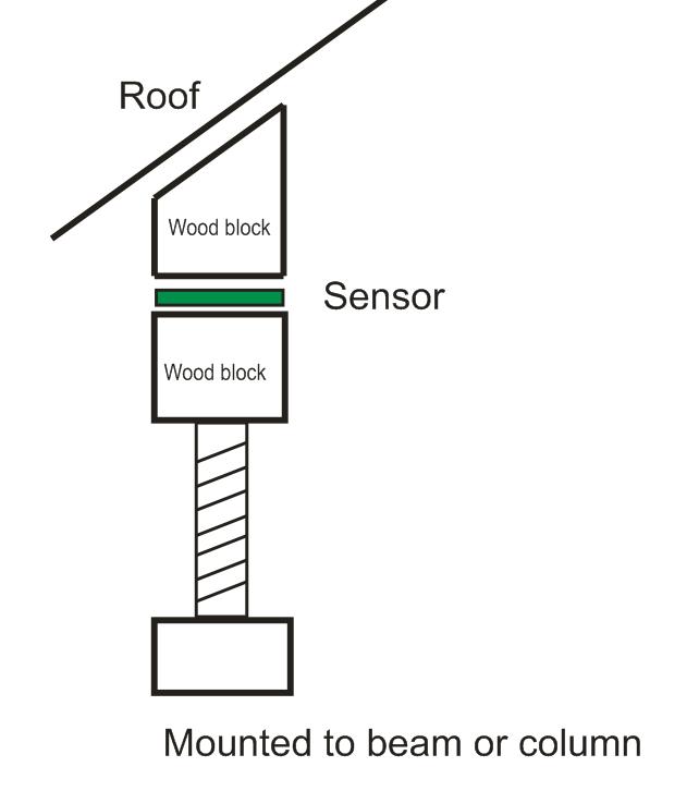

Here is what Ive come up with (attach a picture later) I was thinking of first attaching a 1 inch cube of wood to the ceiling on the inside with the roof mating surface cut so that the bottom of the cube is parallel to the floor. Then sandwich a sensor like this: SparkFun Electronics - Flexiforce Pressure Sensor - 100lbs. in between another 1 inch block of wood. Then the lower block would be attached to a threaded mechanism attched to columns. I could then screw the lower block up or down until the sensor reacted (completely engaging the upper block attached to the ceiling).
The resistance it had would be the starting point and I could then calculate the weight per square inch (once I know what it is per square meter) I could then simply put that amount of weight on the roof and capture that resistance on the sensor. Of course Im not looking to set it at the collapse point...maybe 80% of the maximum specs. With 20 or so sensor setups like this I think it would be cheap and fairly accurate...what do you guys think?

Your scheme will not work.
Yes there will be some load on the sensor as the roof is covered in snow, but you will not get the load per square inch, the roof material has stiffness and will deflect when a load is applied anywhere in the region of your sensor.
To be quite honest, this project sounds like managerial madness, a hare brained scheme dreamed up by a clueless suit, hell bent on having people carry on working in a potentially unsafe building.
I think that you will do just as well to measure the depth of snow at ground level and assume the same depth on the roof.
Knowing the depth of snow, you should be able to calculate the mass of snow on the roof once you know the density of snow.
Your next problem will be to find the density of snow which is far from constant.
