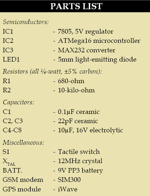

we want to implement vehicle tracking system, by using the attached circuit. Can you please suggest is the circuit is correct with that specifications.
If i need to add please suggest. Thankyou.

Assuming that's not the complete circuit?, then the main problem is the redundant MAX232 - the GPS and GSM modules almost certainly won't be RS232 +12/-12.
You 'may' require some level shifting though, depending on their requirements - you also don't show any power supply for the two modules, nor their switching arrangements.
