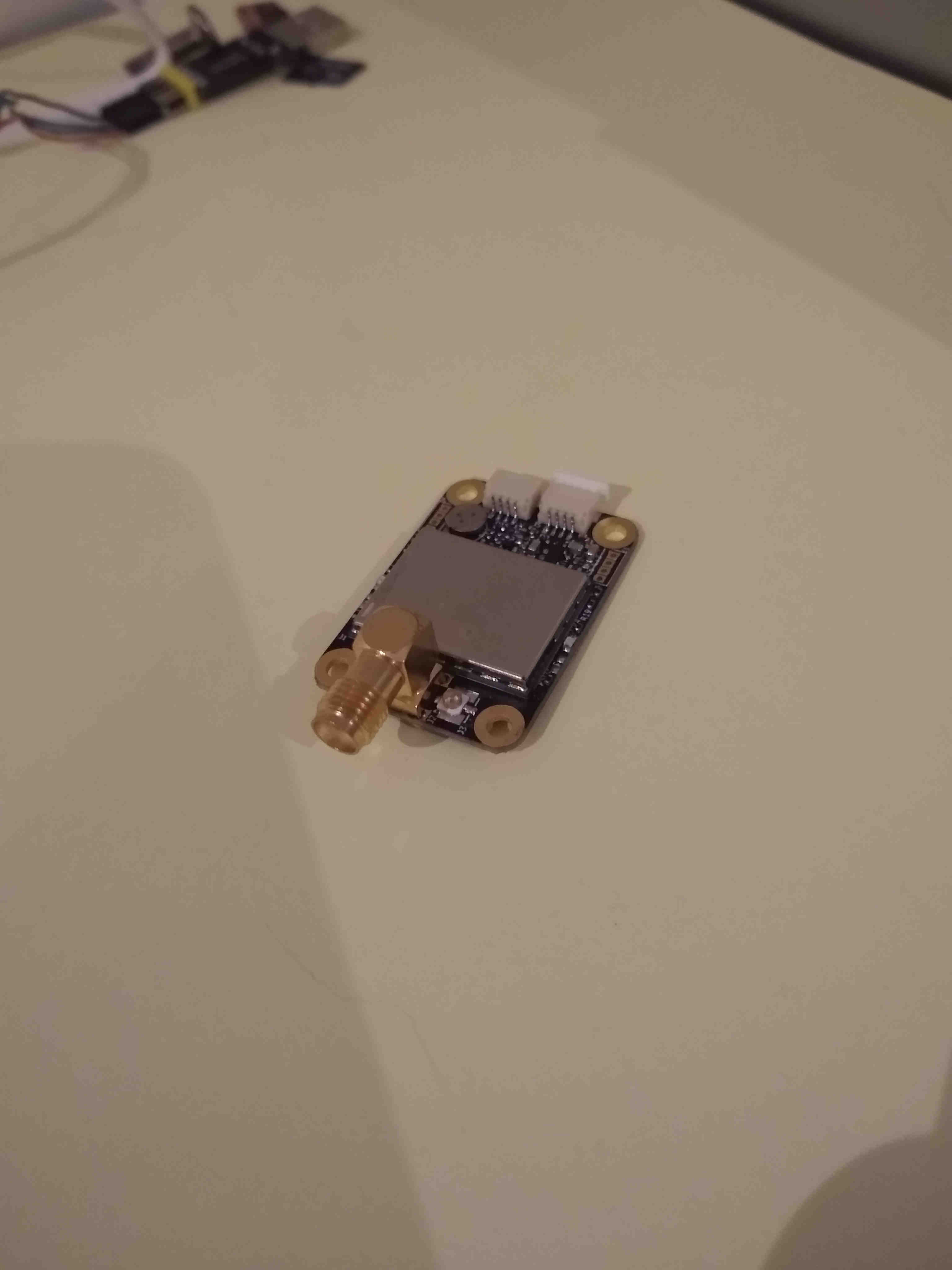

GPS receiver board - can I remove the SMA connector?
loadlover
Your best guess needed! This is a small u-blox GPS receiver board. Can I remove the SMA connector (I must save weight and size), and just use the U.FL connector? Will this have consequences for the RF circuit?
Thanks!
-- Anthony
Hirose UFL is certainly much smaller and easier to wear/ break. Just about the only limitation is the bandwidth application (~6GHZ for UFL vs ~15 GHz for SMA).
